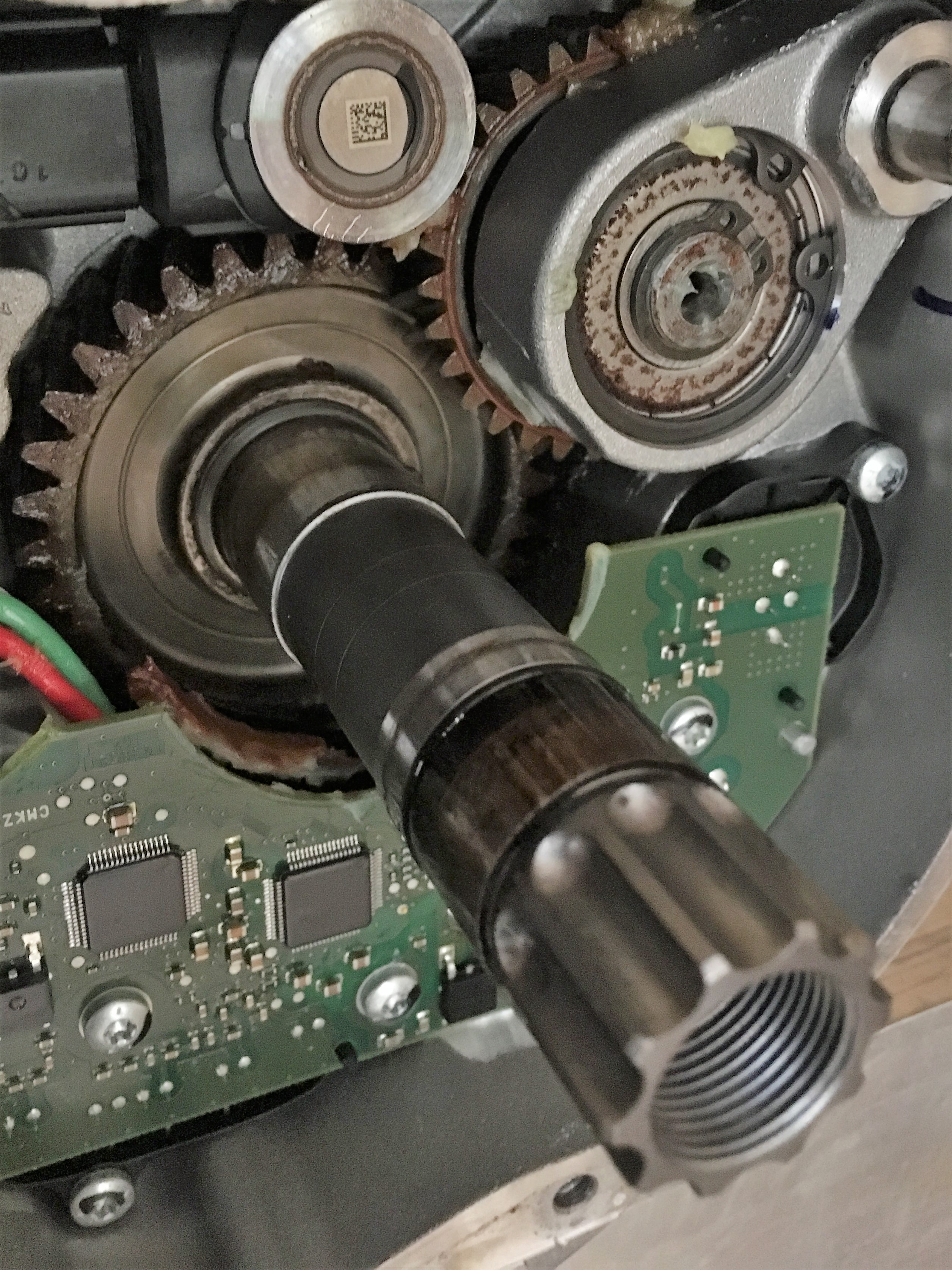

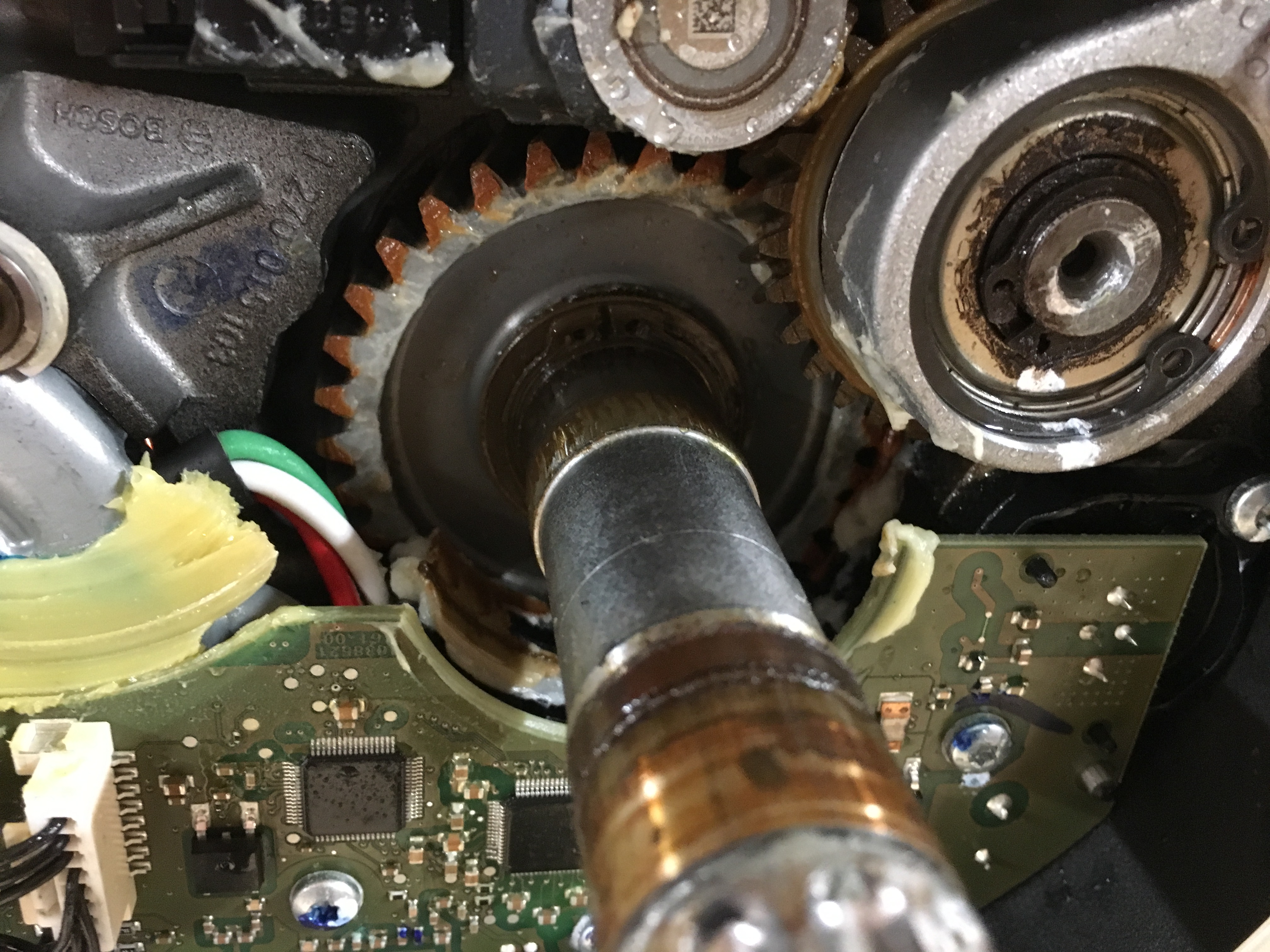

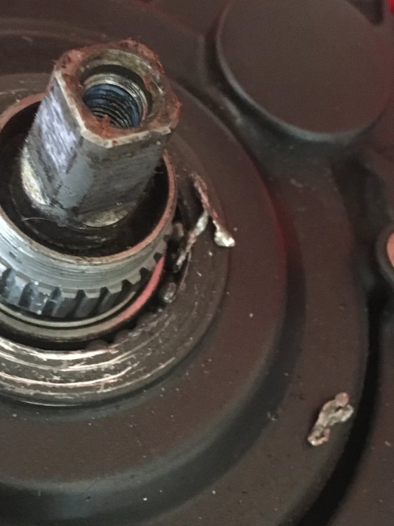

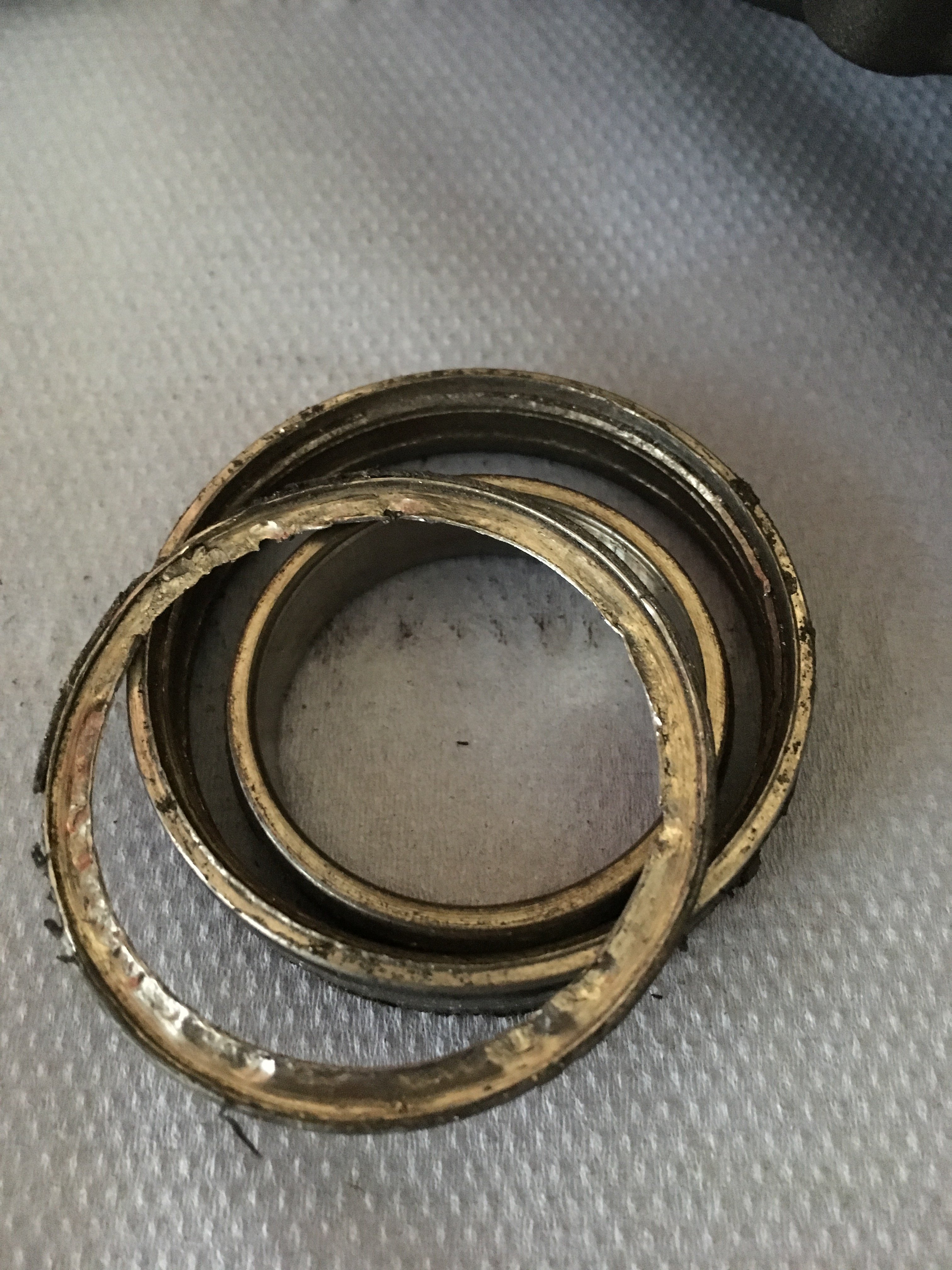

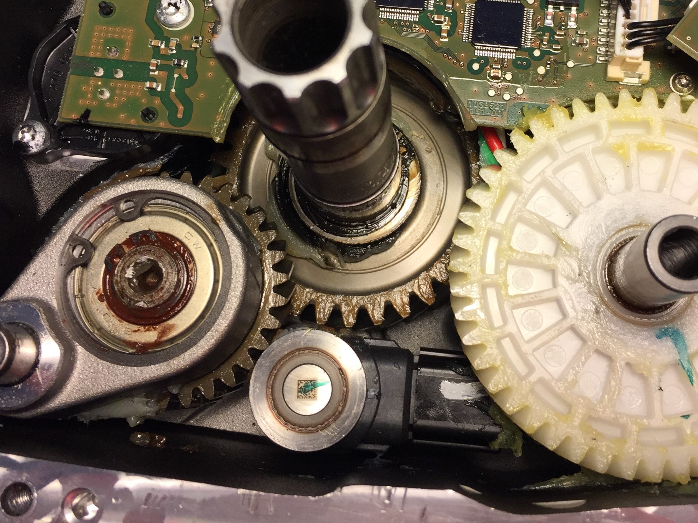

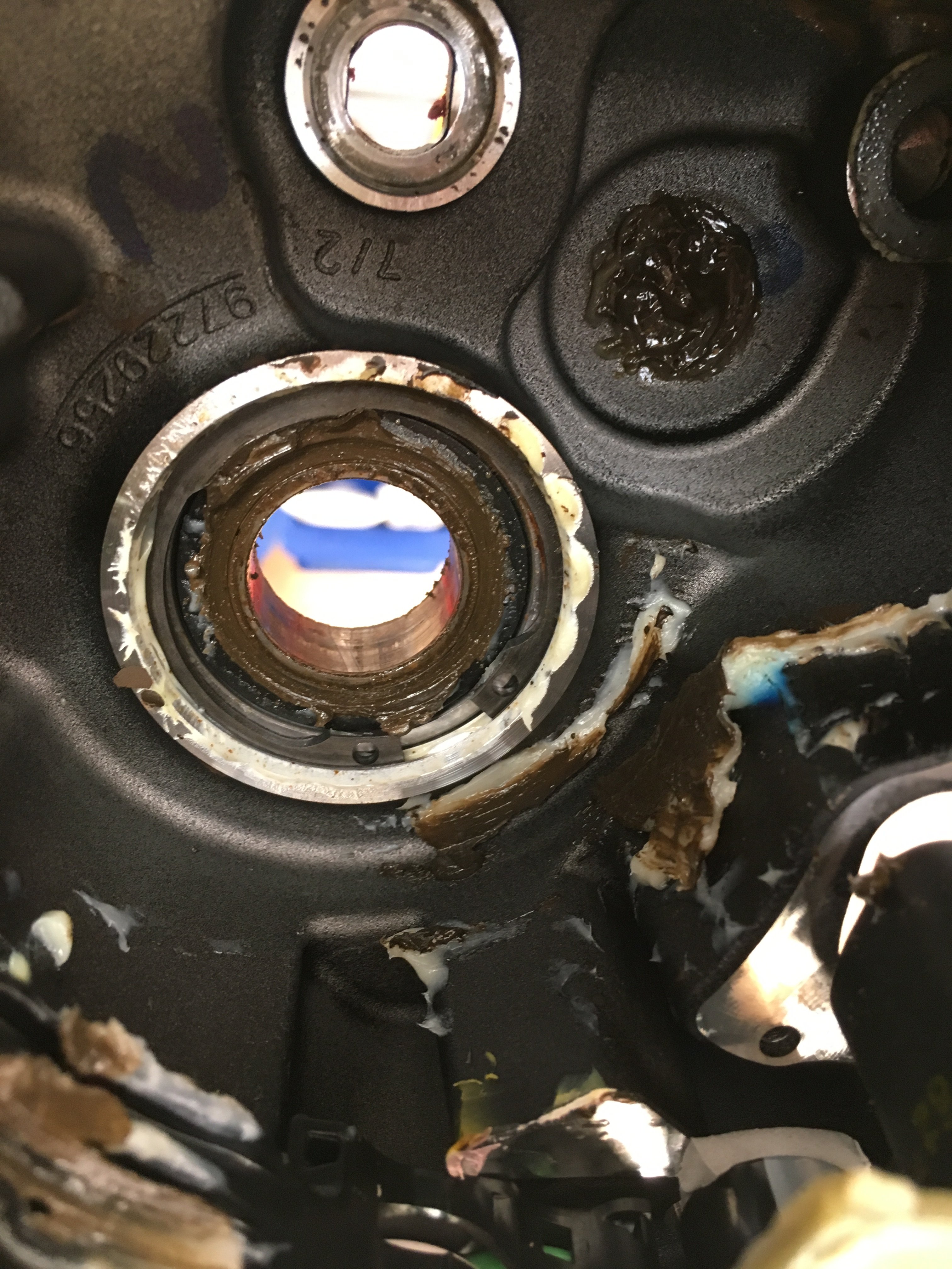

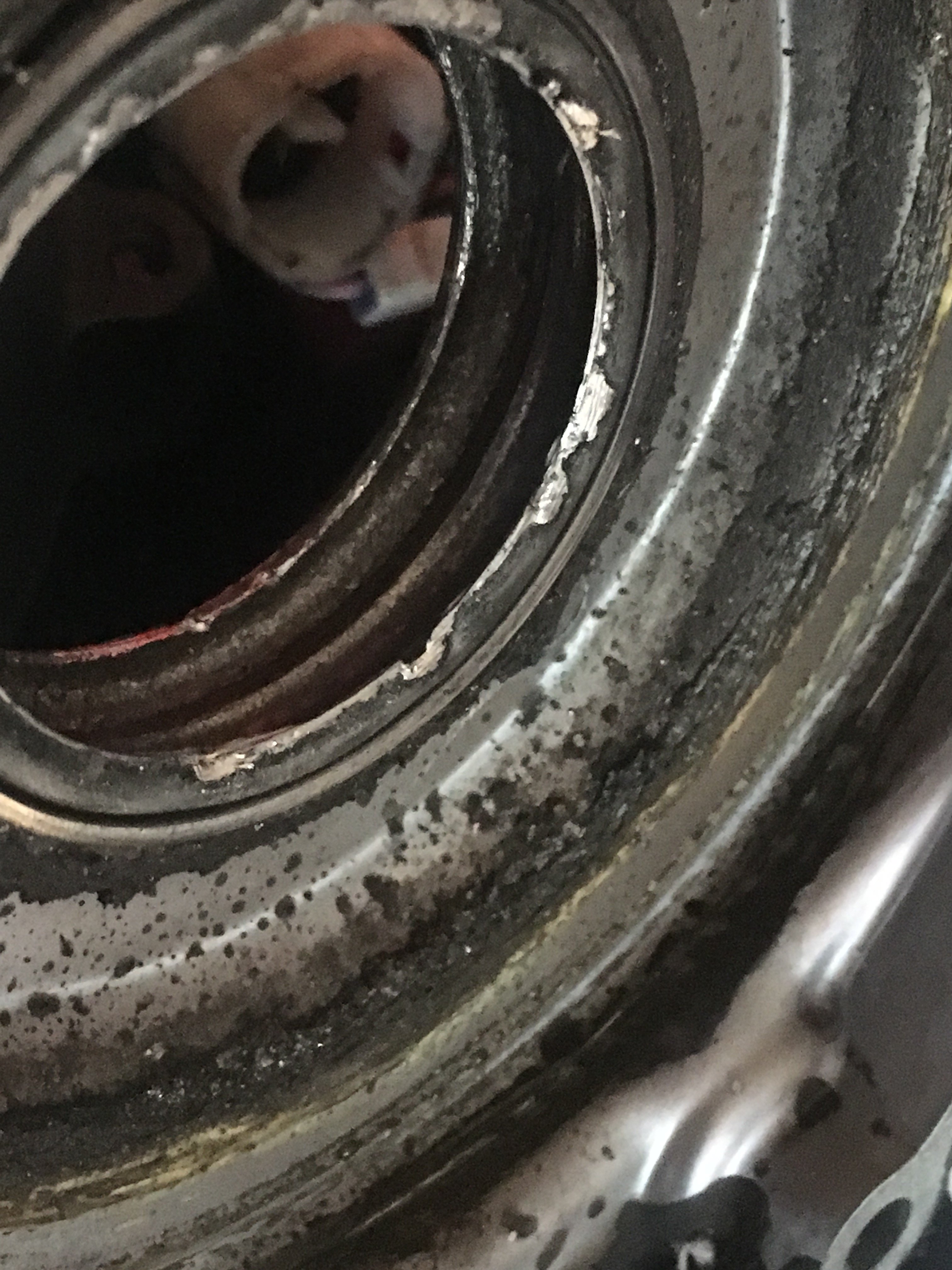

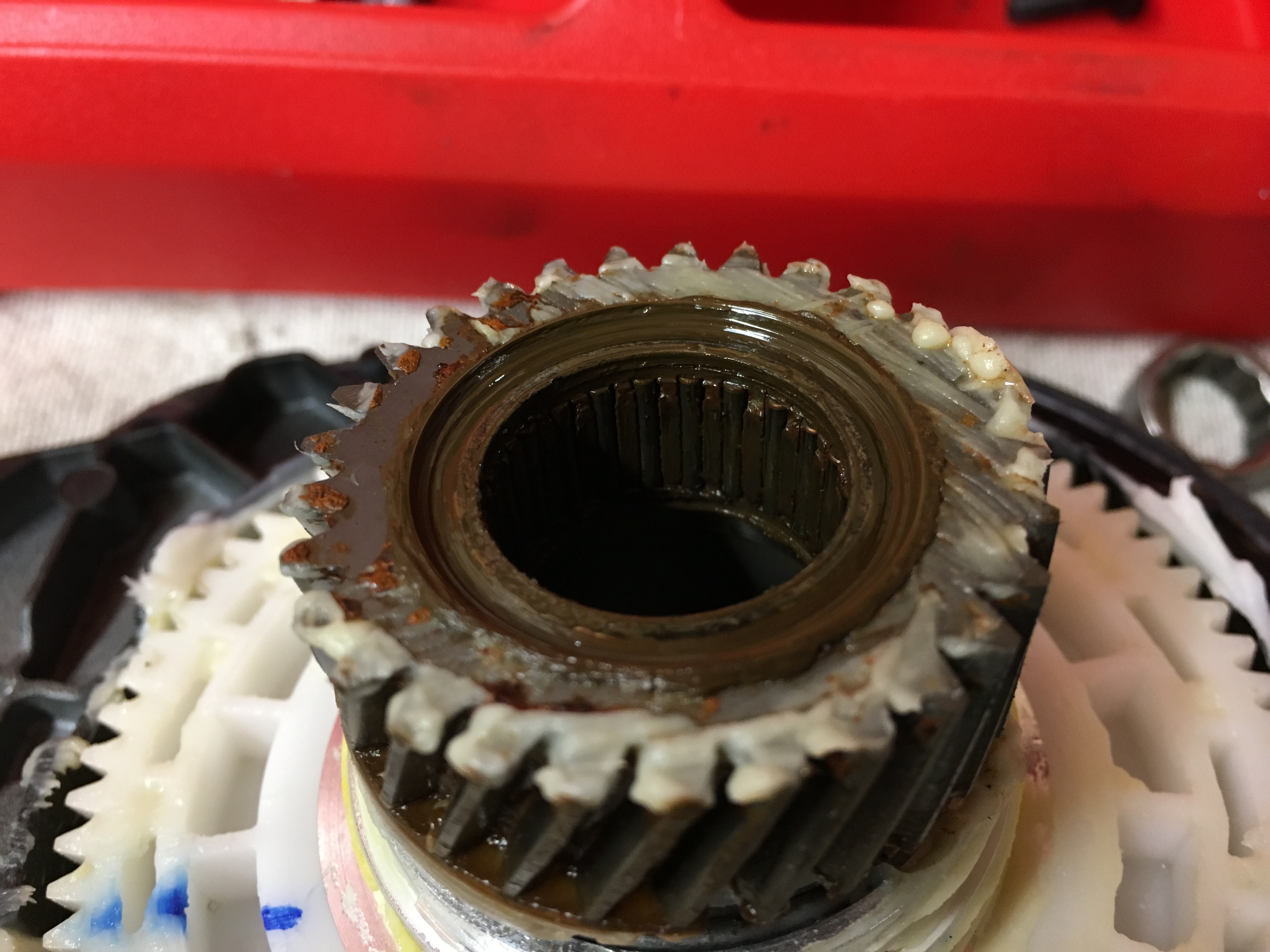

You are all probably aware of the service repair kit Bosch released recently. Designed to replace all the bearings and plastic gears on the right-hand side of the motor. What we have found is these bearings usually fail due to water ingress. The problem is, water also gets in through the left-hand crankshaft bearing too! This obviously damages the bearing and then gets spun out by the crankshaft gear and can damage the transfer gear bearings.
Also, any water coming past the right-hand crankshaft bearing can destroy the freewheel gear bearing.
So, for people and shops that want to do the job properly, we now have a kit available that includes The genuine Bosch service kit and all the bearings required to do the full job! https://www.performancelinebearings.com/product/bosch-motor-service-repair-kit/
Below are some typical examples I see on a regular basis.
Is the Yamaha motor equally afflicted by water ingress?
Yes. The balls inside the bearing are a little larger and less of them, so the bearing takes a little longer to fail completely, but they do fail.
IMG_1371.thumb.JPG.a9eb3b1d64bc87becdffc9290ce75995.JPGIMG_1361.thumb.JPG.e83348024bc4a7e00eb339b3cd463f70.JPGIMG_1364.thumb.JPG.affa87f7075842d2dde0ef1120dbc642.JPG
