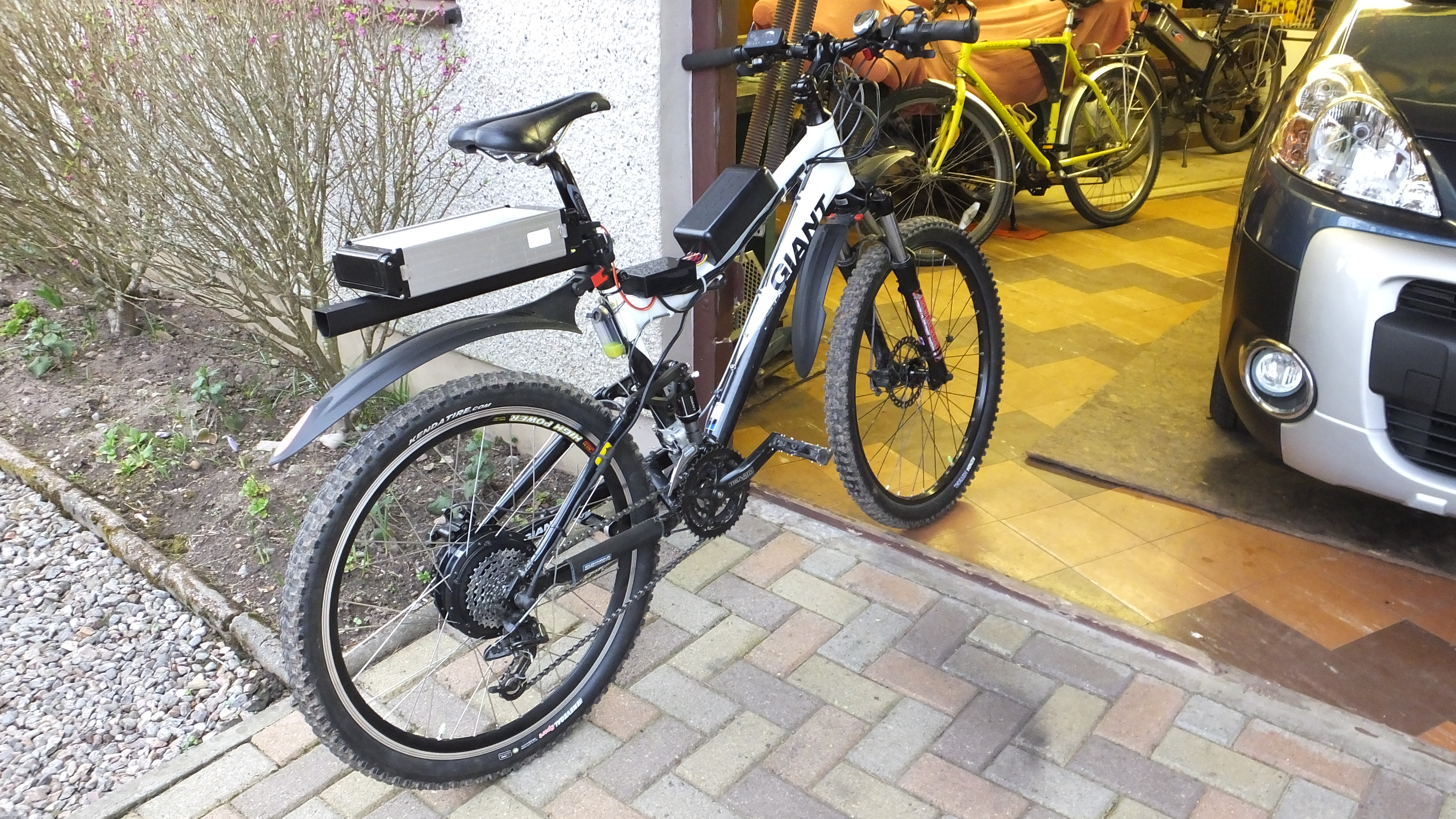

  5. Count yourself lucky! I get by on a rear hub motor and a carrier battery so yes, the rear weight is noticible. You soon get used to it though and the bonus is not much chance of going over the bars on a steep descent!! Plus loads of traction from the back tyre.

  13. Running out of juice after a pathetic 12.2 miles and having to push up the last hill, I realised it was time to replace my Feb 2015 36v LiFePO4 10Ah rear mounted battery. It was one of those book sized jobs with an alloy casing and a euro power socket. Don't see them any more. So considering a Haelong 13Ah which is 1kg lighter, 3cm longer, 2cm higher but a lot narrower. I have to have my saddle pretty high so no problem there. Just one thing. The Haelong has 3-4 different power settings accessed by push buttons.But I have a handlebar mounted controller on the bike which is wired up to the controller already. I assume I can just put the battery on max then at all time. Never sure if Amazon stuff is in the UK or coming from China. Don't want an unexpected cutoms bill!

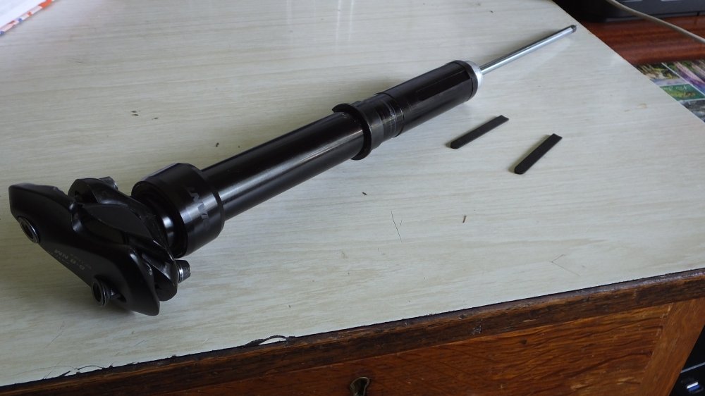

  16. Is it just me, or do you find this rush to make all tools battery operated a bit over the top? They are heavier to hold and do not stay at max power like corded tools do. More expensive even without the battery, which may well become an obsolete shape in a few short years. I have never had a problem with mains powered stuff even at 50m from the plug. The few extra minutes to rewind the cable after use is no worse than the time to recharge the batteries.

  21. It is not the end of the world but I noticed the other day that all the LEDs on the Rider one controller were on as the battery was being charged. Pressed the button to switch off, which it did, then 3 seconds later back on they all came. Had to remove the battery to switch off. I usually charge it indoors so no problem. I was more concerned that this meant trouble down the road. I have already needed a new controller at an expensive £99. I will replace it myself nextime as I know where the connector is, just inside the top tube. It is not a new problem. I saw posts from NZ and Australia pointing to this in 2017. So far it has not impacted on the cycling. Power changes work fine and everthing is normal....except for the switch off. Has anyone else heard of this? Bad wiring connections due to corrosion were mentioned.
  22. Plenty of peddles on Ebay for under £20. If you don't like spikes...and I don't when they bite! just file them rounded at the points then you still have a bit of grip when it's wet.
  23. I had a related problem with my dropper post. It was fine for me as I need a high saddle with a restricted knee bend after a new knee job. When I let thesaddle down so my daughter could use it, I noticed it was very reluctant to operate until raised again slightly. As I discovered when taking it off to repair recently, the cable was scuffed and slightly crushed. The cable had got squashed between the bottom of the seat post and a pivot point on the rear suspension. Luckily the inner cable still runs free.
  24. To Continue, I bought a 2mm white pvc strip from screwfix for £3.29 which turned out to be too thick. I was hoping the extra 0.5mm thickness from the originals would not make that much difference. No matter, it will come in useful elsewhere. Then I found I could get a sample of black Styrene 50mm*50mm, 1.5mm thick from engineering_supplies on Ebay. A stomach churning £1.39 including P&P! 2 strips have been cut off it and the dropper post is now operating butter smooth with no discernable lateral play. A bit fiddly to cut with a stanley knife, so I stuck the sheet to the cutting board with double sided tape to stop it moving about. It may be a weak point of Giant droppers but the piston assembly is easily changed if necessary and cheap at under £50 unlike some other makes. Oh, I do love a bargain repair!
  25. Had a great ride in the Cairngorms yesterday and avoided the showers! But my saddle started to wiggle about, ended up at an 11 degree angle in each direction from foreward. Took the dropper seat post out today and took it apart. As expected from other forum posts, the 2 plastic strips which hold the saddle straight were scuffed on one side allowing them to start climbing out of the grooves they normal fit in. Well, it should not be difficult to buy a couple of new ones thinks I. Wrong! Giant UK do not supply a service kit that includes them. A German supplier does...Euro 11.90. But their postage to the UK is an amazing E29.90. Another Brexit bonus no doubt. I got a couple of other ideas....turn them over so the remaining 'sharper' side is in the groove..might have to glue the duff side to the inner tube. Or someone else wrapped his in alu foil and got a good result. For how long though? These strips, looking like the plain ends of cable ties, should be easy to copy in a soft metal, like aluminium. Brass might be too hard. Provided they wear quicker than the seat post tubes there should be OK. The whole lot is covered with fork butter grease anyway. Should be an interesting bodge by all accounts!
