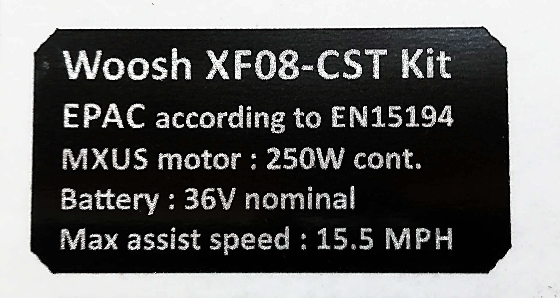

Q4 - I understand that manufacturers need to display some details of the bikes compliance with EU regulations/laws somewhere readily visible on the frame. Does this requirement also apply to converted bikes?
There has been no clarification on this point, but since a label is easy to create and apply, why not do so? It save questions being raised.

There has been no clarification on this point, but since a label is easy to create and apply, why not do so? It save questions being raised..
That's exactly what I thought, so I made a label.
Poor photo, but it is glossy black plastic engraved to reveal metallic silver writing.
