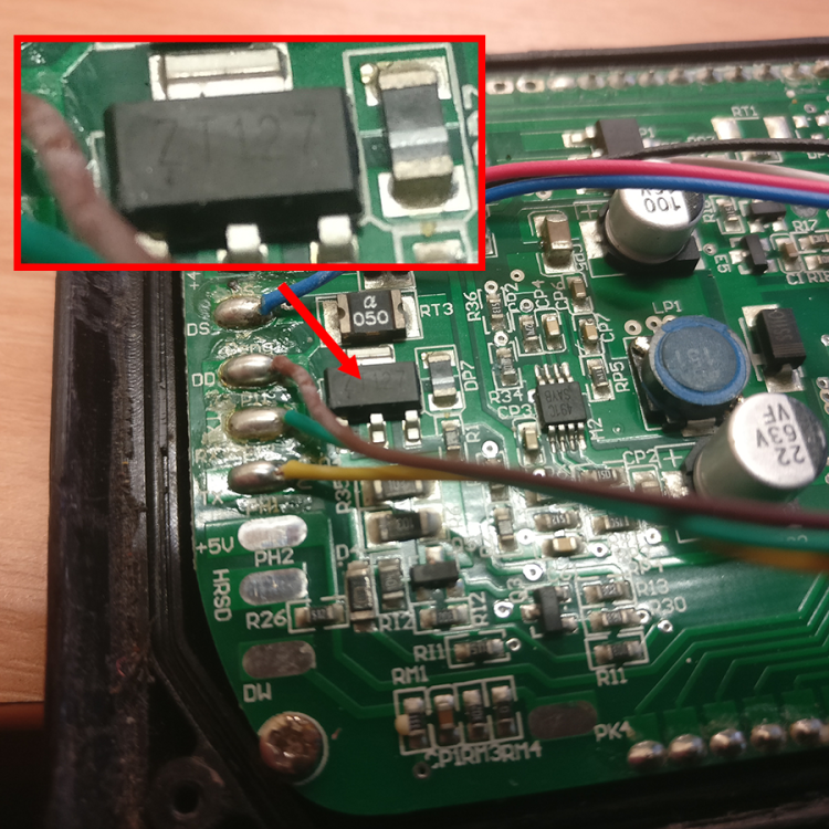

I opened up an old SW900 (pic below). From the transistor data sheet, it looks like it can take a decent load, but I don't know how much it would take without cooling. At the moment, I think the LCD light cable can power a 15W LED headlight. The battery voltage across those wires would be about 50V max, so the current would be 15/50 = 300 mA. The rear flashing light can be on with the controller (maybe through a 555 timer if I can't find a flashing red light. Does anyone concur?

The red wire going to the LCD has battery voltage, which is used to power the LCD when you press the power-on button. When you switch it on, the CPU in the LCD does two things: It latches the power on, and it switches a transistor to also latch it to the blue wire, which runs back to the controller and powers it. When you press the button/s for the lights, the CPU switches a different transistor to latch the red wire to the brown. The brown then has battery voltage to work the lights or anything else that you want to connect to it.
Some controllers have the brown wire (or other colour) in the controller. When you operate the button/s on the LCD/LED panel, the panel sends a communication signal to the CPU in the controller to tell it to switch on the transistor in the controller that latches the wire for the lights to the battery wire.
The lights that go up to 60v have their own buck converters in them so you don't need to use an external one. I'm pretty sure that they have inductors in them, which I would guess have blown your transistor. To connect anything with an inductor in it to a transistor, you need a protection diode, like this:

You have to look at the tracks on the LCD to see whether the brown wire is connected to the same transistor output as the blue wire or whether it has its own transistor. Up 'til now, I've been speaking in principle from how other LCDs work. I've never studied the SW900.
I've never see an unswitched brown wire for lights on an LCD before. You get them on many controllers though.
It's got it's own transistor. It's the same basic circuit as the S866.

All the ones I have seen are no-name Chinese ones. I've seen other SW900s, but never with the separate wires for the lights like yours, neither have I seen them on any Bigstone or Kingmeter LCD. I know some SW900s have the brown wire in the cable going to the controller, but I don't know what happens at the other end. I can only speak about the general situation. Many OEM bikes have the transistor for the lights in the controller because it's a common failure that I've had to repair many times.
I've just looked back through the thread. You show three different LCDs. It might help if you tell me which one you're talking about. I was assuming SW900. The first cheapo one you show, I am very familiar with, as i sold a load to forum members, and it has the separate brown and white wires for lights.

Going back to basics. Unless the LCD or controller's manual tells you the rating of the brown wire, you have to treat it with caution. That's why people recommend a relay, but even with a relay, you need a protection diode. You need a protection diode when you connect anything with an inductor (coil) in it. If you know the rating and you have a light that's well within it, there's no problem. They use these things on many OEM bikes, though the lights are generally low power and crappy. I recommend to everyone who wants to fit anything that requires battery level supply to connect directly to the battery wires because you know that it can provide enough power without blowing a transistor.
