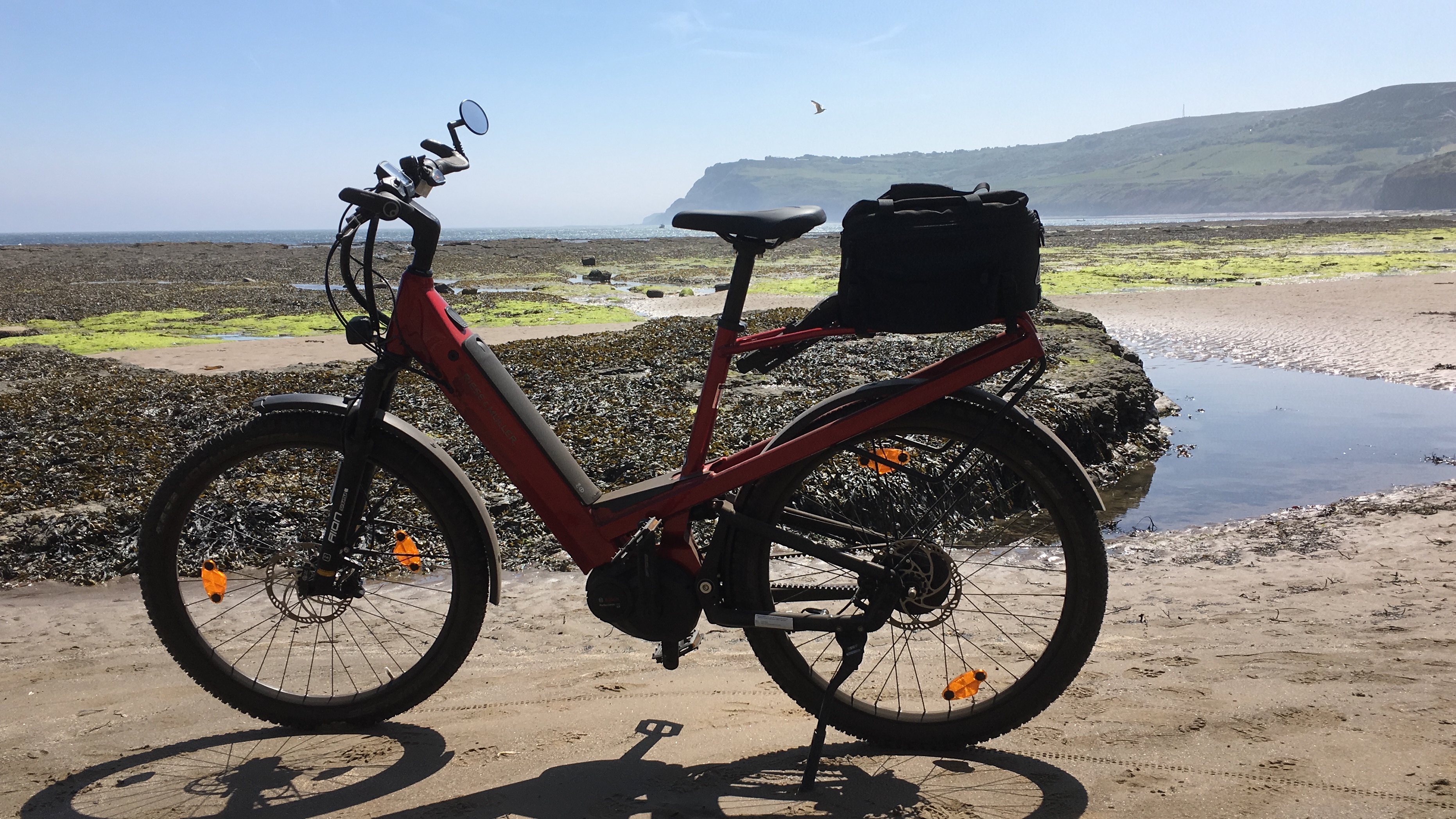

On the beach at Robin Hoods Bay looking towards Ravenscar
Today, as I suggested yesterday, I rode the bike to Robin Hoods Bay with the intention of getting back up the very steep hill. Those who know the area will know just how steep it is, but I couldn’t guess the gradient.
Before I report about today’s trip, I have a few things to say about the Homage that I omitted yesterday. The first is that it is a surprisingly large bike. I’m 6’ 3” tall (1.9m in new money) and the bike is R&M’s 58cm frame which is suitable for body height 1.80 - 2.00 m (5’ 10” to 6’ 7”). I have a high and upright riding position, which is one of the benefits of a step through bike. It took me a little while to get used to stepping through the frame - I kept putting my leg over the saddle as I had with previous bikes. Of course, the downside of this upright position is that drag is greater than the more conventional position used for compact diamond frame bikes. I’m not worried about a bit of extra drag - I’ve got a battery!
Now back to the trip to Robin Hoods Bay. The first stage to Ravenscar was a repeat of yesterday so I will not add to that. The weather was warm, clear and sunny with a moderate eastern wind blowing off the sea. I stopped at Ravenscar to take stock of the battery, which still showed five bars. I had used Eco mode for the gentle ascent to here and decided to continue to Robin Hoods Bay - downhill all the way but, of course, I needed to conserve enough battery energy for the return journey.
Bobajob, one of this forum’s Pedelecers, had asked about noise levels from the Bosch CX motor and about my ability to pedal the bike with the power assist switched off. I had tried switching off during the ascent to Ravenscar and found that I could only sustain sufficient speed for a short while. This was on the soft surfaces of the Cinder Track with a slight ascent so, given the weight of the bike (about 26kg) it was not a surprise that I found unassisted pedalling hard work. Downhill from Ravenscar was a different story - I turned the motor off and virtually freewheeled all the way. There were times where there was a slight incline which I managed but in a few places where there were steeper sections, I switched back to Eco or Tour modes. Bobajob also asked about noise levels from the CX motor. In Eco mode there is a barely detectable hum which is almost overwhelmed by the crunch of the knobbly tyres on the Cinder Track surfaces. In higher power modes the motor gives a reassuring “whir” which I didn’t find intrusive.
I arrived at Robin Hoods Bay in reasonable shape given the challenging surfaces encountered. It’s ten years since I last went this far on my old bone shaker because the poor track acted as a disincentive. In places it is severely rutted with scattered bricks and rocks protruding and in others there are deep potholes. The full suspension of the Homage coped very well. The only incident was a bit of fishtailing when I entered a long, steep sided rut with very loose and deep gravel undersurface. I need to pay more attention. The battery at the top of the hill still showed five bars so I decided continue down to the beach. Very steep descent with the bike fully under the control of the hydraulic brakes. No problems. A short stop on the beach (see phot) before trying the ascent. I selected Sport mode and the lowest gear ratio the Enviolo hub could offer. I didn’t make it to the top as I ran out of oomph with about 100 m to go. A nearby bench provided an opportunity for a lunch stop before I continued to the top. I pushed the remaining 100m as I didn’t think I had it in me to reach the top by pedalling. In retrospect my mistake was to select Sport mode which assists proportional to my torque input. Of course, tired legs, less torque, less assist followed by stopping. I think the bike would reach the top but my 70 year old and tired legs couldn’t meet the challenge. Next time I will select Turbo mode.
The return to Ravenscar was carried out mainly in Tour mode which gave extra assistance to tired legs. I certainly appreciated this extra energy! I reached Ravenscar with five bars still showing, which I find amazing. The rest of the journey south towards Scarborough was again carried out mostly with power switched off, apart from some gentle ascents where Eco was used. The battery indicator showed four bars after 35 miles, so I'm fairly sure that my 500 Wh battery option was the right choice for me.
My next expedition will be a trip to Whitby and back. If I can do that on my 500 Wh battery I will be delighted. I’ve lived adjacent to the Cinder Track for 30 years and I’ve never been able to complete a return journey to Whitby on my old bone shaker, so that next trip will be a major milestone for this Rookie Pedelecer.
