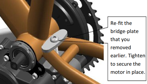

Squeek Two - another long story short - the Dawes frame is what's known as a lugged frame and where the TSDZ2 Bridge Plate secures the motor against the chain stays was the problem in that the Bridge Plate was not siting squarely on the frame lug. On dismantling I could see bare metal where the plate was wearing away the lug. Repositioning the Bridge Plate solved the problem for a while but I never did entirely eliminate this re-occuring problem. The motor is now on a non-lugged frame.

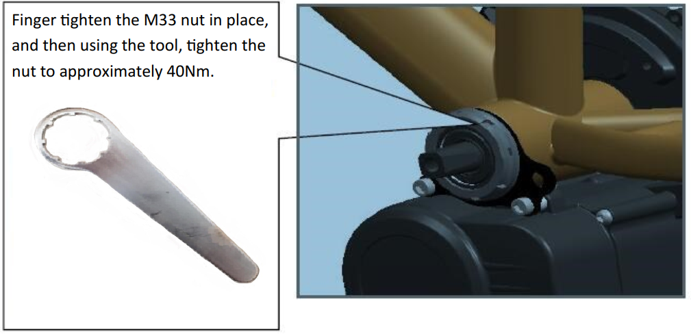

2. The lock ring - just by using the supplied tool with hand pressure is not enough - after hand tightening I tapped the tool with a mallet to get a bit more torque to something like the 40nm required on this piece too.
OK, so for some reason your motor may have a defect in which case you've been unlucky, but with 4 motors installed (and more than 5,000Km on my own), I've not had any undue problems.
The pics below are possibly from the Woosh manual for the TSDZ2 installation -a company whom I'd recommend for their excellent customer support and documentation.
1671702731782.png.5c2de78d7d11d08e36c187c06fc970c7.png 1671702756299.thumb.png.a2cb106862ff12efc179d8bac105cd2a.png
