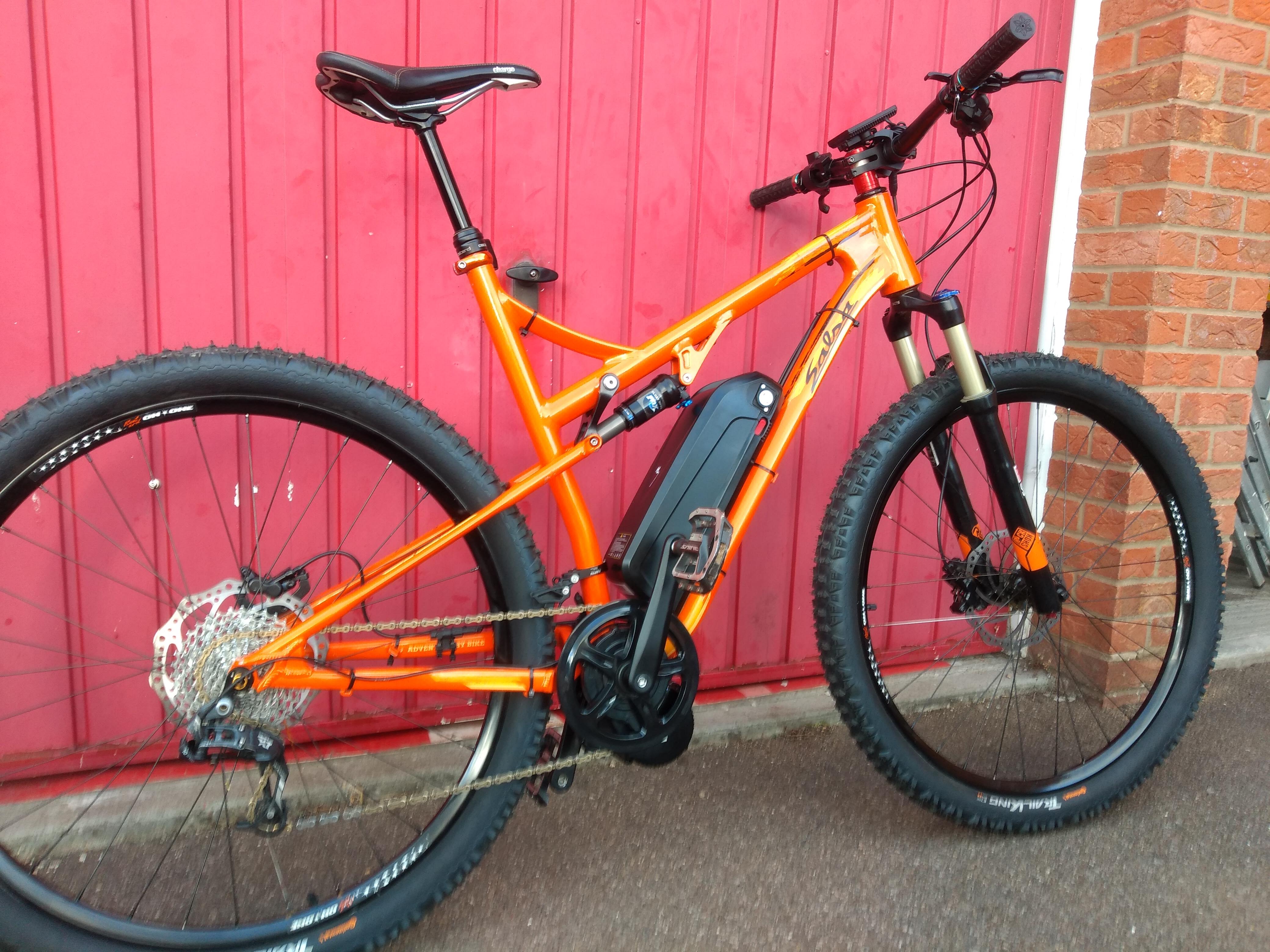

The tsdz2 is a 750watt 15 amp motor but the bafang draws 25 amps at 48v the watt meter in the display shows >1200 w in short bursts but would be even higher if you used a 52v battery
I like the feel of the tsdz2 in normal use but for outright fun around the farm the bafang wins the torque is far higher at>120nIMG_20200821_182931688.thumb.jpg.517a66f0be3d254f90b36359e40455a9.jpg
