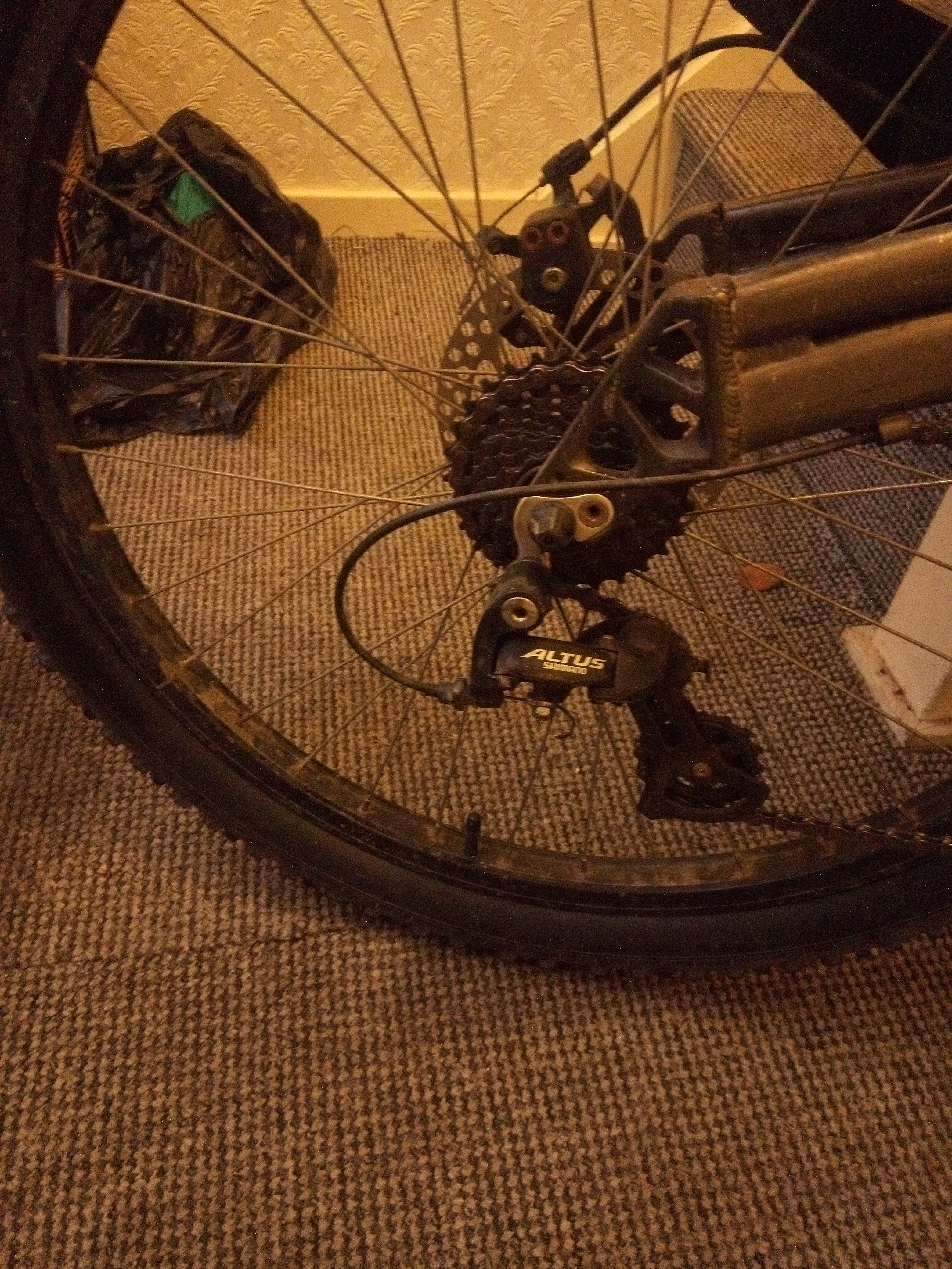

Thank you for your suggestions so I have uploaded a pic do you think any of them kits you suggested would be ok again tha k you for all your help I'm literally new to all this and trying to figure it out lol

Your photo id from too far away for me to see clearly, but it looks like 8 speed free-hub gears, which means that you need a cassette motor unless you want to go down to 7-speed, so back the Woosh kit or one of these:

Sorry mate I just counted them there is 7 gear changes on the back, sorry about the bad picture
Then you can use a freewheel motor in the previous links or a cassette motor. The freewheel ones will probably be easier to install.

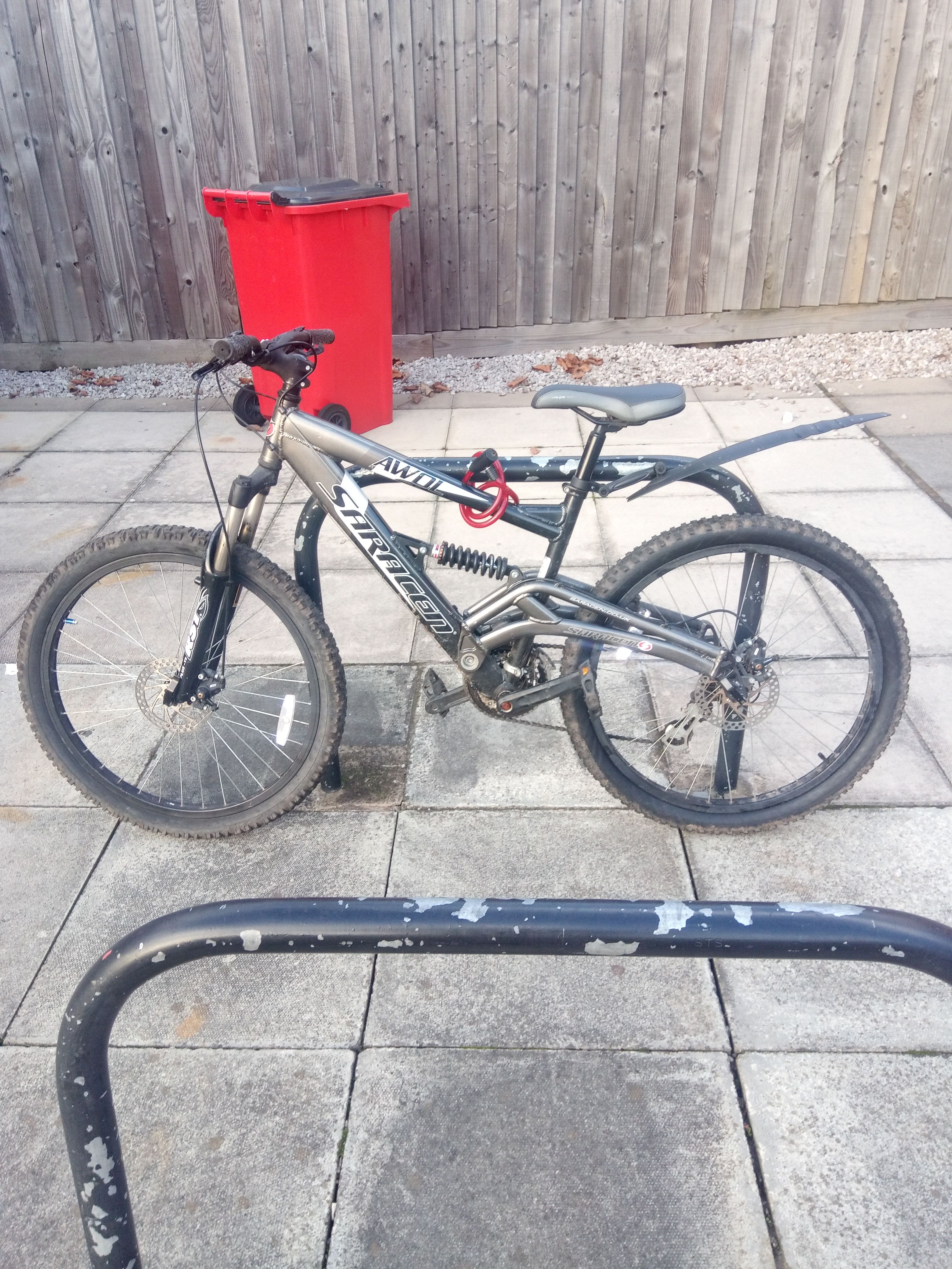

Is there something extra I need to get if I have hydrolic disc brakes some one said on a review for a kit they don't work I have tektro 0h, I'm sorry I feel so out my comfort zone trying to get the right kit Amazon say there kits fit all 26" but I can't see it and eBay is in my price range I know they don't come with bsttery
My bike is Saracen AWOL if that's any good

Show a photo of your bike because there are different versions and frame sizes. Battery installation is probably going to take a bit of lateral thinking.

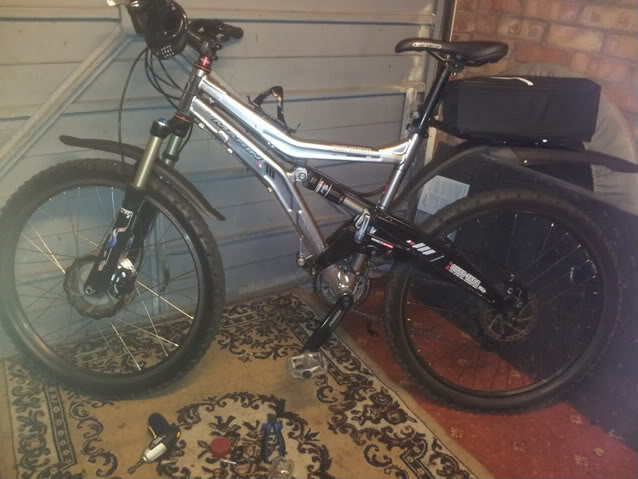

I'd get another bike to use as a donor - any one with a triangle frame and disc brakes. I've done one similar to that before putting the battery on a cantilever rack behind the seat. It was OK, but the handling is never as good like that because you have to have the battery extra high to clear the suspension. Also, you need a steel rack, and they're not easy to find. The normal aluminium ones would snap suddenly at some time in the future.
