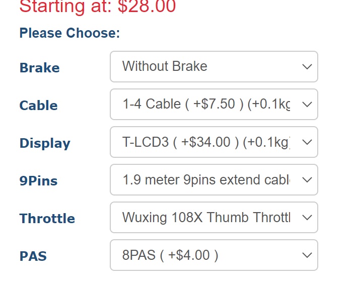

A few days ago, a guy posted about his conversion with that controller with photograph/s. It would be much better to fit a throttle than use the walk-assist function.
You have to cut the motor cable somewhere and solder all the wires. I'd cut the connector off that's under the chain-stay and add the standard 9 -pin connector.
http://www.topbikekit.com/t06s-24v36v250w-torque-simulation-sine-wave-with-julei-waterproof-connector-p-732.html
Ah ok I would like to see that conversion with photos I will have a look in the conversion area.
im fine to cut the wires and solder less confident when it comes to diagnosing the correct colours as I doubt they match
was the link to show the Julei connectors Or to show the controller itself?
