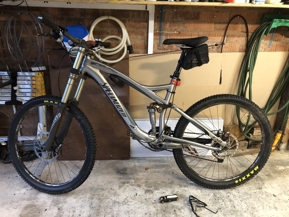

January 27, 20215 yr Hello All, I’m trying to get ideas and parts together for a conversion of my 2007 specialized enduro FS, I’ve been looking at previous posts and it appears that rear hubs are mentioned more than CD, is that the case for full suspension? Mostly used for trails, canal paths and a few hills around Rivington (Bolton) The frame triangle is pretty small but I’m tempted to have a go at building something, I’m an electrician and I have got access to a couple of hundred 18650s which are two or three years old from medical equipment. Hoping the above is enough information to get some advice. Thanks everyone.

January 27, 20215 yr It's fairly easy to make a battery case out of 3mm plywood, then cover it in the really thin firbreglass cloth before painting. Either a crank motor or hub motor would work. A hub-motor is better if you want to use your bike as general transport. A crank motor is better for off-road and sporting use. The BBS** will be angled downwards because of the shape of your frame, so ground clearance isn't going to be fantastic for serious off-road use. It looks like you have a standard Hollowtech BB, so fitting should be very straight forward. There's a bit more involved to fit a rear hub-motor, but the work pays off in the long term if you use your bike for general transport, commuting, etc.

January 28, 20215 yr My neighbour has a fitted a whoosh kit a couple of weeks ago, I will try to measure his standard In frame battery to double check it definitely won’t fit in my frame, the chamfered top of your battery looks like it would help get it in? the standard in frame battery measures 361mm L x 90mm W x 92mm H. You can try with a piece of cardboard. One of my customers put the battery in a triangle bag.

February 5, 20215 yr Author I’ve bought and received the kit and am looking forward to fitting it hopefully this weekend, I checked my frame and the standard battery does fit in but not with enough height to release it from the cradle, I’m hoping to create a foam lined bracket that will hold it in place.
