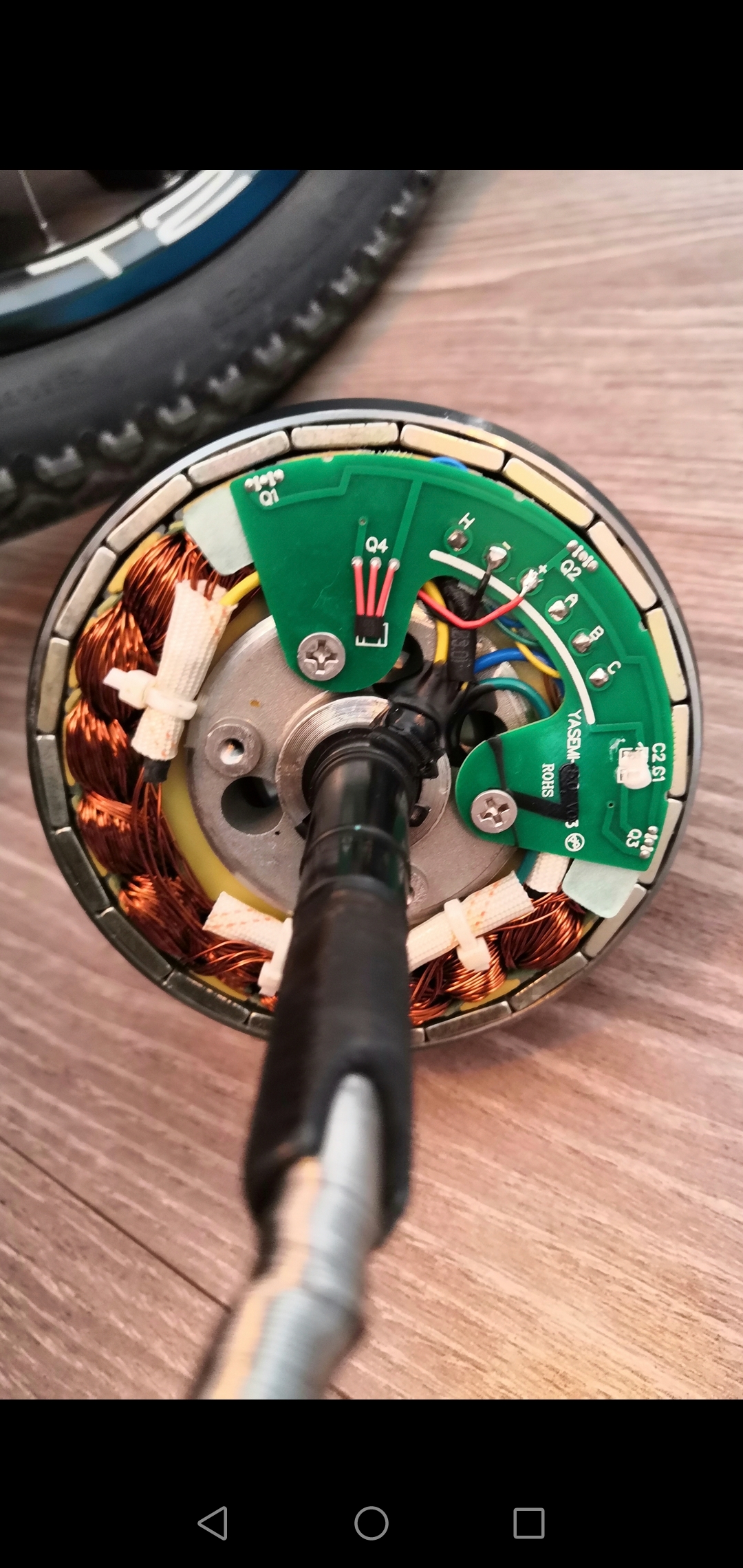

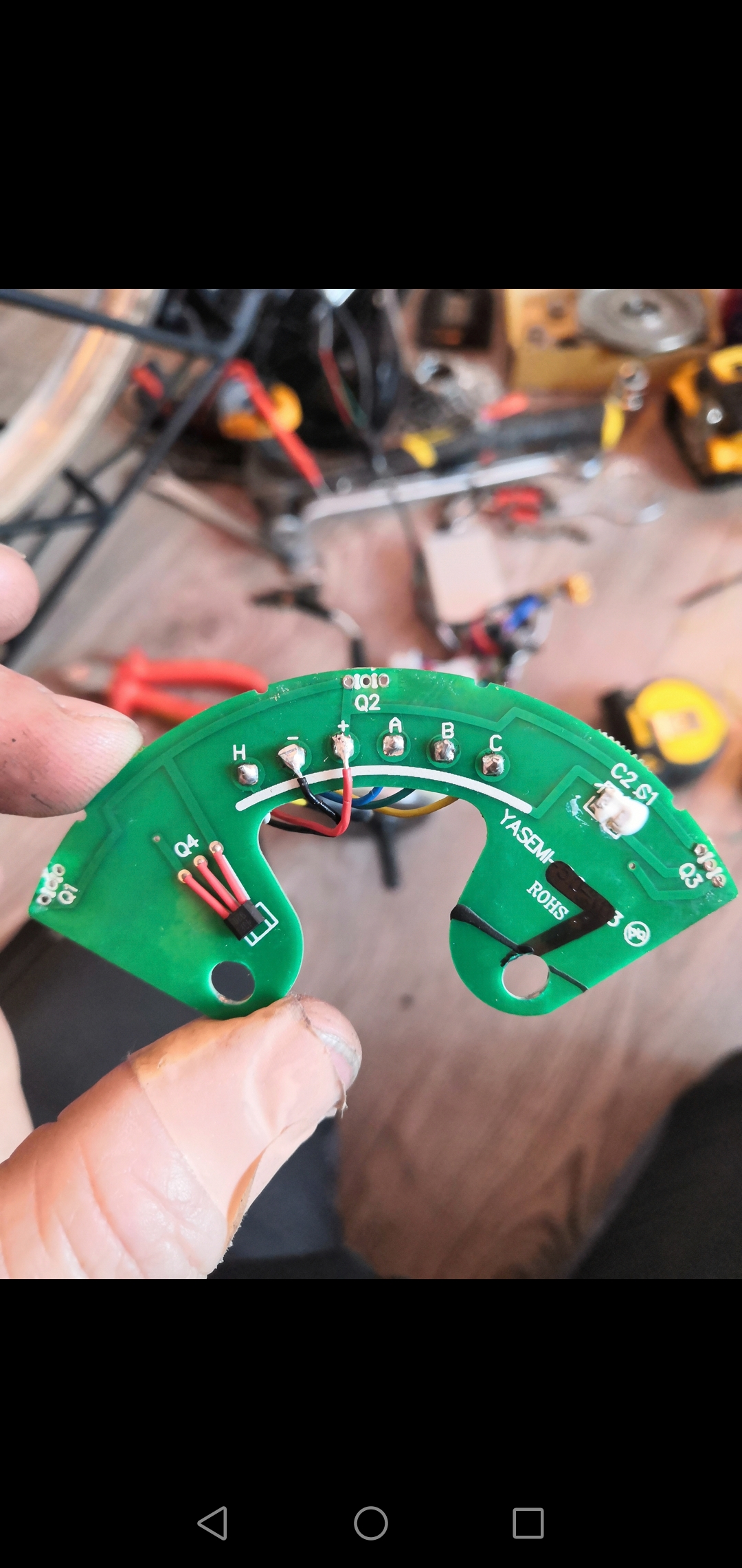

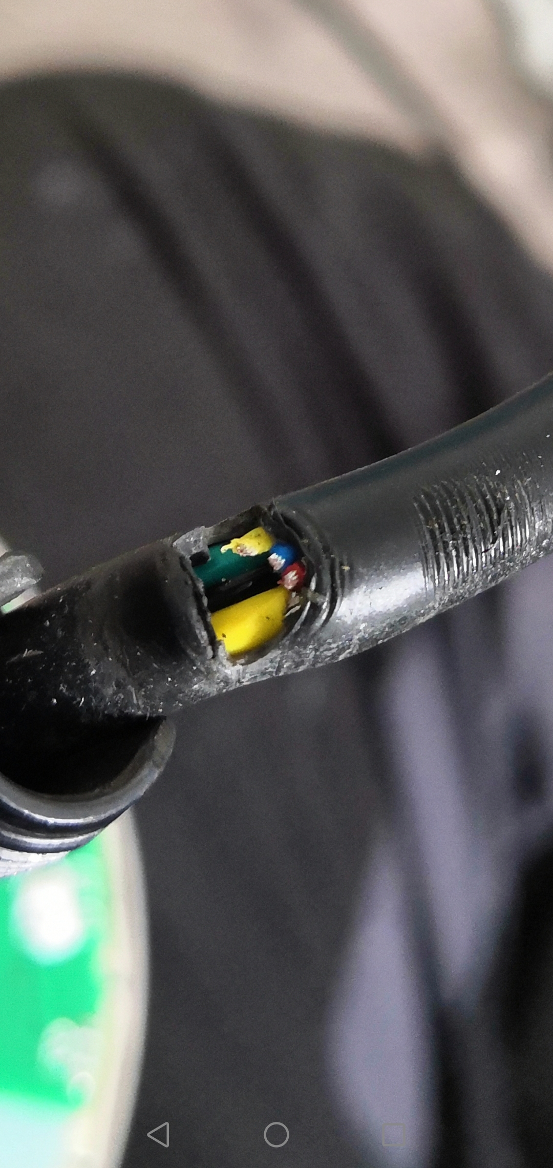

OK so my hall sensors weren't working on this motor due to a damaged motors cable.
I didn't have enough space to clear all the silicon and pull the cable through to re terminate it with the hall sensor pcb in situ. I de soldered the board ok but carelessly I managed to break a leg on one the halls. I knocked the leg and bent it but when I Straightened it up if broke off.
I manged to cut out the damaged section of cable and re terminated the phase cables to the stator and for now I slid a bit of heat shrink over the hall cables and tucked them out of the way.
Do you know if I'll be able to get hold a new pcb with the hall sensors attached or should I buy loose hall sensors and then use my existing pcb.
Also for installing the hall sensors do you remove the stator completely and glue them in?

Buy loose hall sensors. They cost nearly nothing. You'll struggle to find that exact hall sensor board as a spare part. You can use any bi-polar sensors, but there is a caveat. The sensors come in different versions. Some have internal regulators and some have integrated pull-up resistors. SS41 is the recommended type, and they normally work with normal controllers, but yours might have an internal pull-up resistor. It's best to read the designation on yours and buy a direct equivalent. They're all available on Ebay.
OK thanks its all back together for now but I'll strip it down and try and dig them out next weekend. What sort of glue do people use. Will any high temp epoxy work OK? On the video I watched he used wax paper to stop the epoxy getting on the magnets is there any other material that I might have lying around the house?
You only need the tiniest amount of epoxy to hold the halls still, so none should get anywhere else. the glue is only to stop them from moving, not to fix them in.

OK so I stripped the motor again.
The only way I could get the hall sensors out was by removing the stator from the casing.
The old hall sensors were in really tight. I couldn't make out the markings on the originals so I just bought a few ss41 hall sensors off ebay.
All fitted and back together they work fine. The e07 error is cleared from the display and the motor runs so much better and quieter. It doesn't bog down and cut out under a heavy load like it was doing sensorless and I'm very pleased with it. Thanks for the advise.
