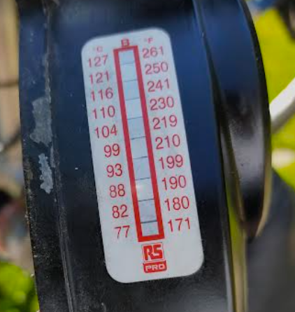

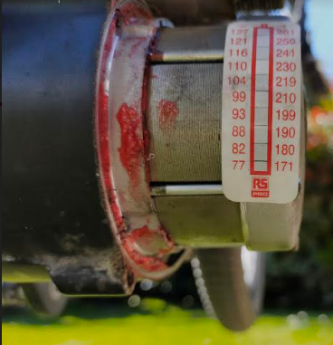

  • To monitor motor temperature I used RS Components ‘RS PRO Non-Reversible Temperature Sensitive Labels’ which come in various temperature ranges and cost less than £20 for 10.
  • These are on shot temperature sensitive strips and I fitted one label to the outer motor casing for any early warning of over heating, and one to the motor itself (It takes around 10 minutes to remove the left crank, motor assembly lock nut and motor casing and re-assemble).
  • As you can see from the pictures, neither label has registered any temperature above the label’s lower reading of 77degC. (The red gunk in the pictures is ‘red rubber grease’ which I use on the motor casing seal).
  • Further, I did on a regular basis during riding, put my hand on the motor casing to see how warm it was and it never got anything above luke warm.

1655973659037.png.663ed860f5a7cfbcb3d793dc85b5f77a.png 1655973685742.png.0dfe536dc0c3188813f658c7e310f537.png
