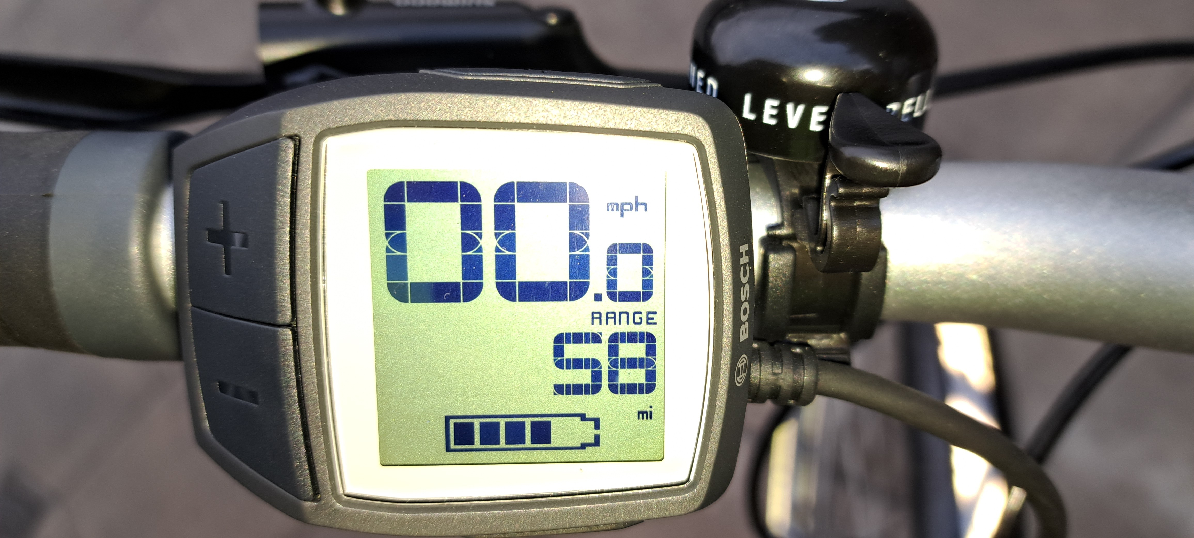

Appreciate your reply, thanks for getting back. I am not exactly overly fit but used to cycling, used to do 20-25 miles ok on a normal hybrid (non e-bike) bike so comfortable cycling etc. On Crossfuse I am using the gears & going in to lower gears in Eco mode rather than in a higher gear in Tour/Sport mode so was expecting way higher range than mid 30s in Eco mode on non hilly routes eg last 21 mile cycle was 800 feet elevation, mainly towards the last few miles. My display range starting off as 36 worries me as I was expecting it to be much higher & I could understand it reducing when I was making less effort and/or using greater assistance. When you are using your bike, getting '52 miles range' as an example, does this include when you are pedalling greater than 15mph & motor stops assisting? And what does your display Range show as left when you are going? (Sorry for all the Qs but I can't find decent real info online so invaluable to speak to another owner - and I haven't used the bike very much so need to use it more).

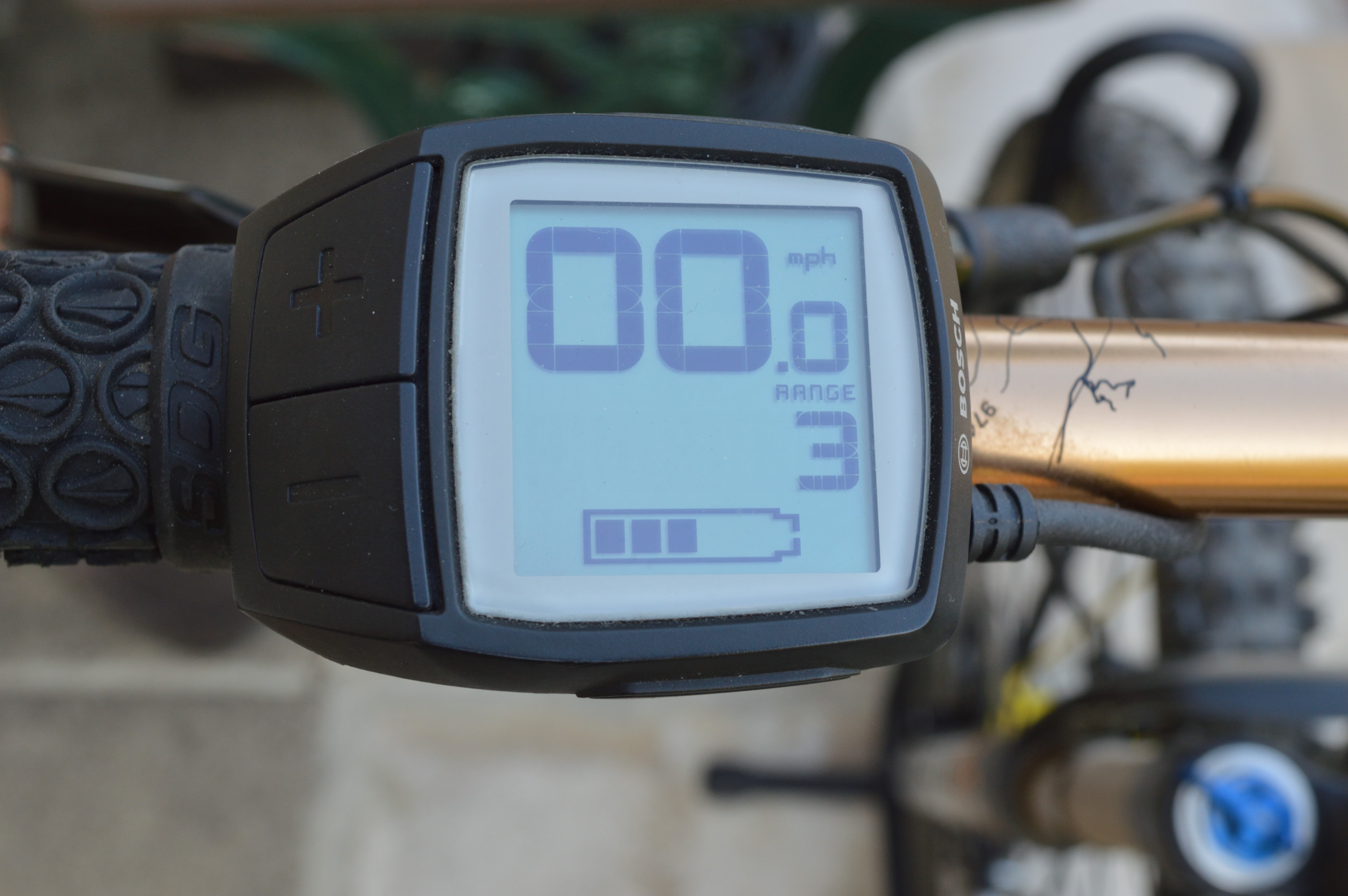

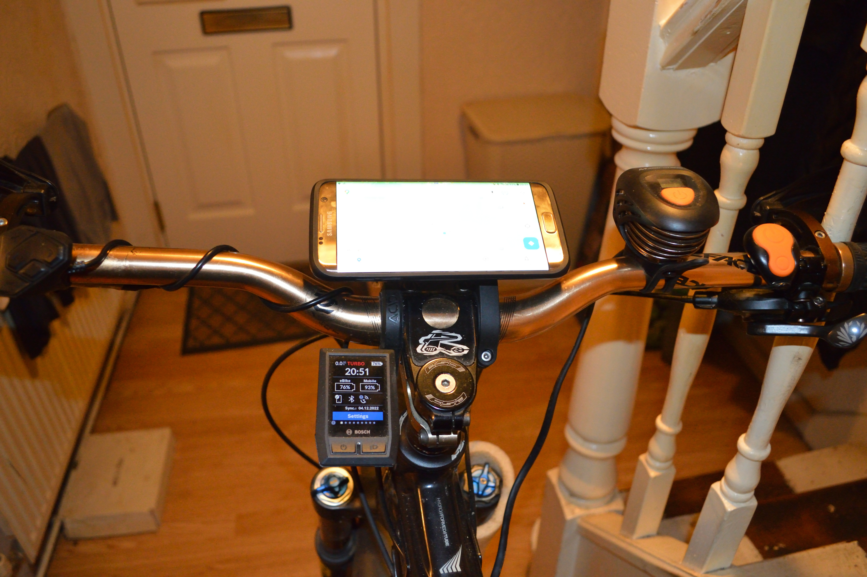

i have a kiox display now so can see the batt in 1-100%
https://winstanleysbikes.co.uk/bosch-kiox-retrofit-kit
I'm kind of hoping the battery light indicators (ie a rough % of battery usage) may almost be a better indication than the guesstimated Range until I get more miles & rides in.
its in 20% /5 bars but you need to charge the batt a few times to get the best capacity out of it from new.
if you get a kiox display then you can also have the app on ur phone and record ride data and link it to stravia or koomot

The Bosch range on the bike display is very erratic as it is based on a very short history; maybe a couple of miles or less.
