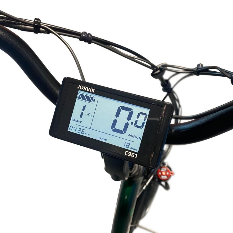

January 4, 20242 yr A simple shunt mod might be all you need. It costs nothing. If you want to know more, show pictures of your motor controller.
January 4, 20242 yr Author A simple shunt mod might be all you need. It costs nothing. If you want to know more, show pictures of your motor controller. is this it??

January 4, 20242 yr Author Yes they will but I wouldn't get your hopes up. I can't see where the controller is currently located and it has hardwired lights. People have swapped out parts on prebuilt bikes before but each design is a new challenge, it depends what the bike shop find. The trike uses generic parts so that's a plus. is that the "controller" that I showed in the picture above?
January 4, 20242 yr is this it?? No that's the display unit. Controller could be hidden in the frame or in the hub motor if bafang have started doing in-built controllers, I'm not sure.

January 4, 20242 yr and how do I get a "simple shunt mod"?? Need to see the controller first. It's either in the frame behind the fold or in the base of the battery. It's where all the wires go. If it's in the frame, it'll be the aluminium box type, which should be easy to adjust. The ones in the battery base are harder because they're normally potted. Shunt mod means add a blob of solder to the shunt to change its resistance. The controller measures the current by the voltage drop across it. When you change the resistance, the controller allows more current because it thinks it's delivering less than it is. We used to do this modification a lot. It's normally safe to increase current by 20% from 15A to 18A. 30% is probably the limit. I'll explain more when you show the controller.
January 4, 20242 yr Author Need to see the controller first. It's either in the frame behind the fold or in the base of the battery. It's where all the wires go. If it's in the frame, it'll be the aluminium box type, which should be easy to adjust. The ones in the battery base are harder because they're normally potted. Shunt mod means add a blob of solder to the shunt to change its resistance. The controller measures the current by the voltage drop across it. When you change the resistance, the controller allows more current because it thinks it's delivering less than it is. We used to do this modification a lot. It's normally safe to increase current by 20% from 15A to 18A. 30% is probably the limit. I'll explain more when you show the controller. Can you see the controller on the picture above?? I don't know what I'm looking for.
January 4, 20242 yr Can you see the controller on the picture above?? I don't know what I'm looking for. You fold the bike, then look at the rear side of the fold. I'm only guessing, but it's probably behind a panel that you can unscrew. Take a photo if you're not sure.
