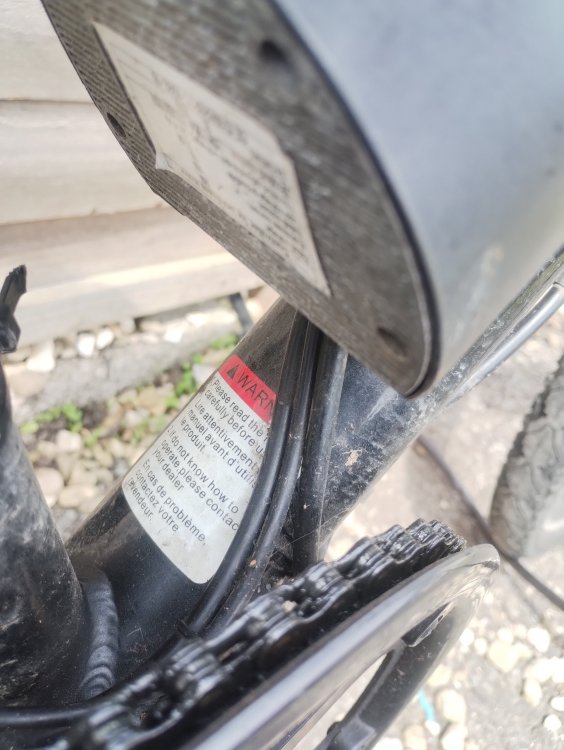

The current wires connect into the old cradle like this (below):
All with connections like this from the wire on the cradle to the wire on the bike:
(these don't pull apart -or at least not easily- as far as I can tell)
One wire goes to the pedal sensor, one to the motor in the rear wheel and one to the components at the handle bars.

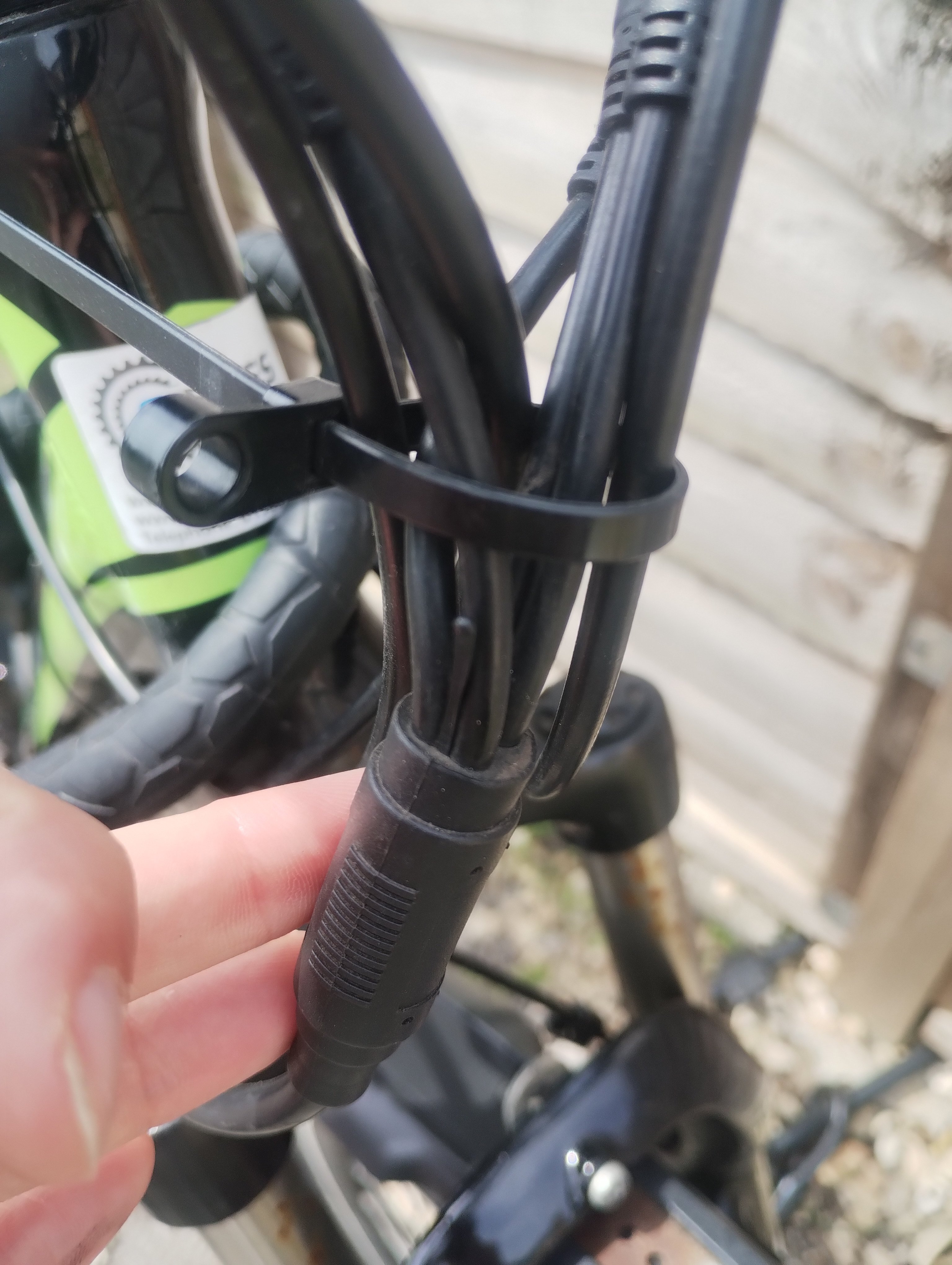

The collection at the handle bars is connected as pictured below
IMG_20240521_115022087.thumb.jpg.0c2ef673f9e751b805275d39e2bd72b8.jpgIMG_20240521_115030422.thumb.jpg.9f0e87e5e0f5b97107a47cb750d28b48.jpg

One has the controller in it and the other doesn't. Obviously, you need the controller.
The controller is removable by undoing the 4 screws in the aluminium bit, but it will remain hanging by the two battery wires. You'll probably have to cut the wires, then solder to the new ones. You might be able to unscrew the nuts that hold the spring-pins in and remove the ring terminals to avoid soldering the wires, but remember which side the red wire goes. You have to hold the pins on the other side with pliers while you unscrew the nuts, otherwise they go round with the nut and nothing unscrews.
Alternatively, you can unscrew the whole black bottom part from the aluminium rail and only swap the top part if it's broken. You can also just swap over the top part if the catch/lock is broken.
The connection system is in that black bottom part above the controller. It's only two pins with springs underneath, so if you're not getting a good connection, it's probably because the pins are a bit jammed by dirt. That can easily be fixed by cleaning and oiling and a bit of pressing in and out with your fingers until they're free.
