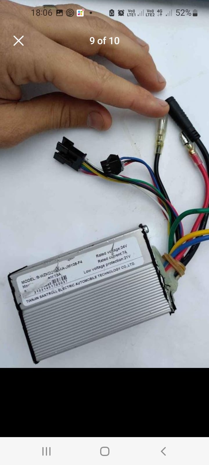

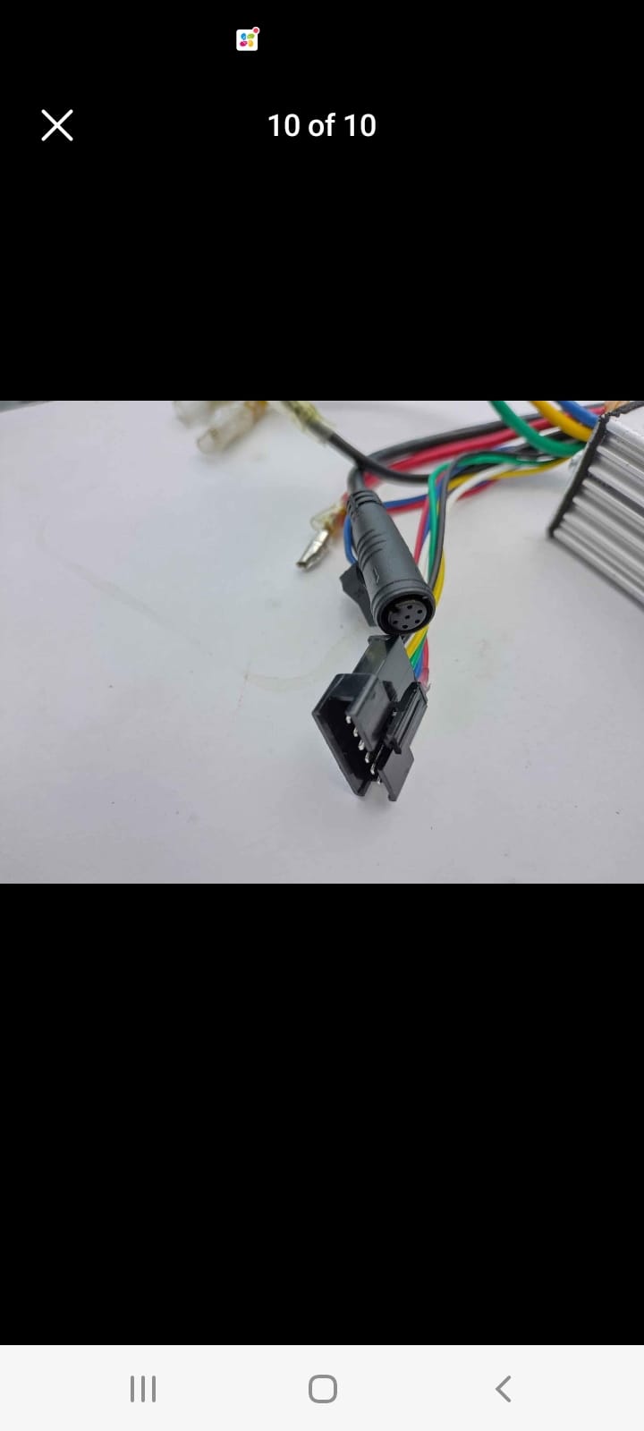

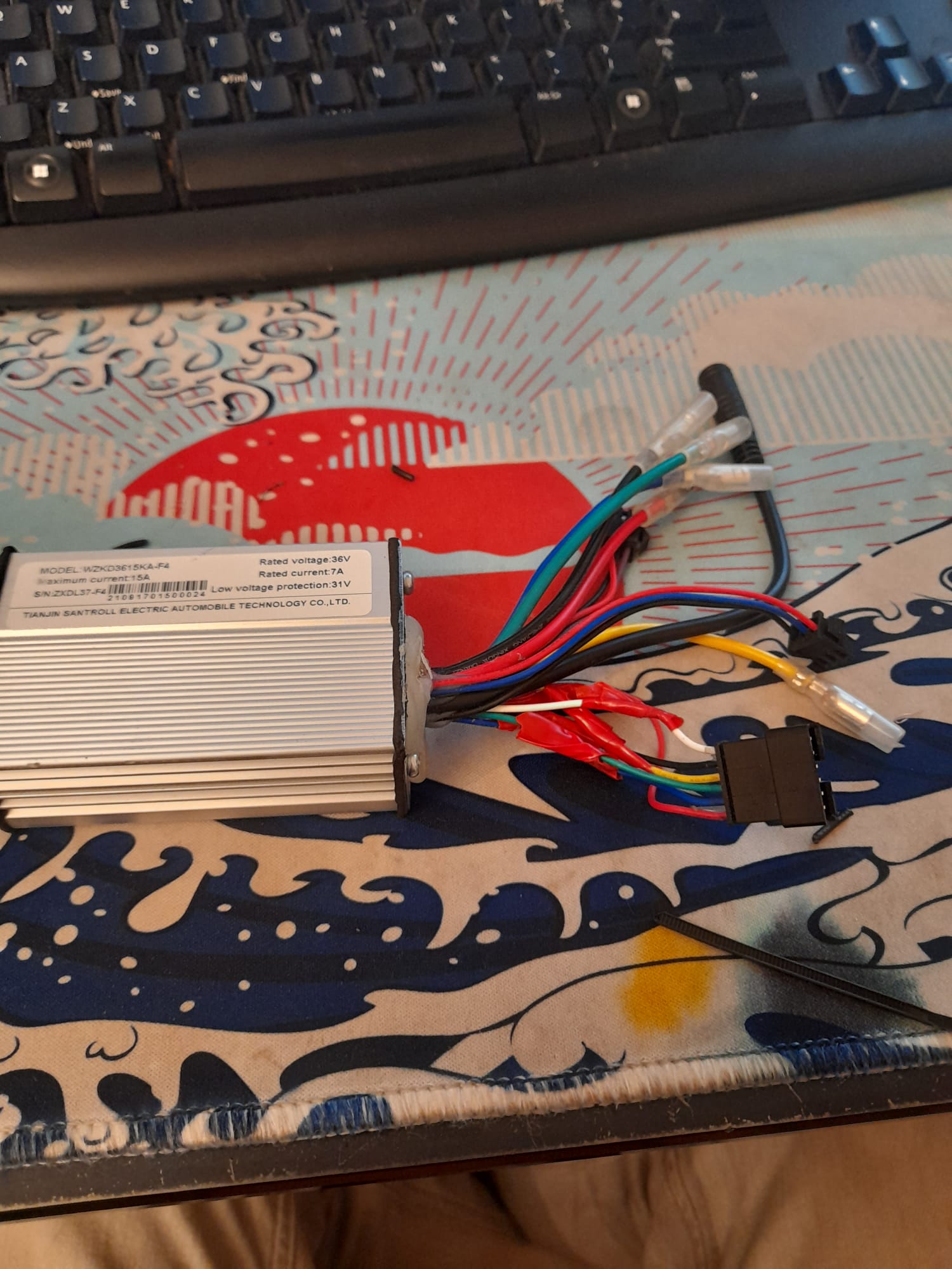

However, now there is another problem, the controller for the bike is of a different kind. The previous owner probably burned the original controller, and tried to replace it. The controller he has bought is for 36v instead of 24v of the original battery, and the controller. So I am stuck with not usable controller, and not working bike obviously.
The original controller was (TIANJAN SANTROLL ELECTRIC: B-WZKD24(Unknown)KA-JM10B-F4)
I have got WZKD3615KA-F4, 36v with a low protection of 31v, obviously it does not work.
Could you please help me choose a controller, on a very low budget, that will power up the bike, and use the breaks, and other stuff originally implemented in the bike?

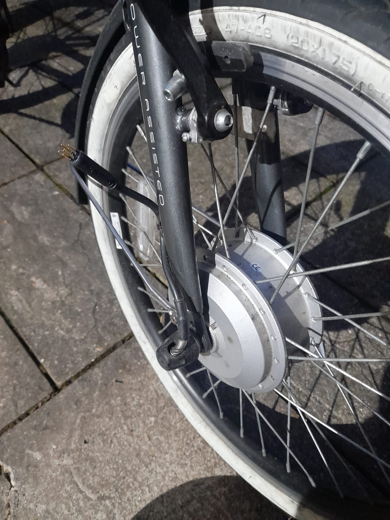

Your wheel is upside down.

What do you mean by wheel upside down? There seems, no meddling with the wheel. How does it supposed to be?
My main problem is the controller. The one I have got is of no use. Can you advice on any I can get from ebay?
Common out of factory fit error is to install the motor wheel with the cut/open portion of the axle where the cable exits facing upwards, this will let rain/water into the motor, refit the wheel with the cut portion facing DOWN!!!
