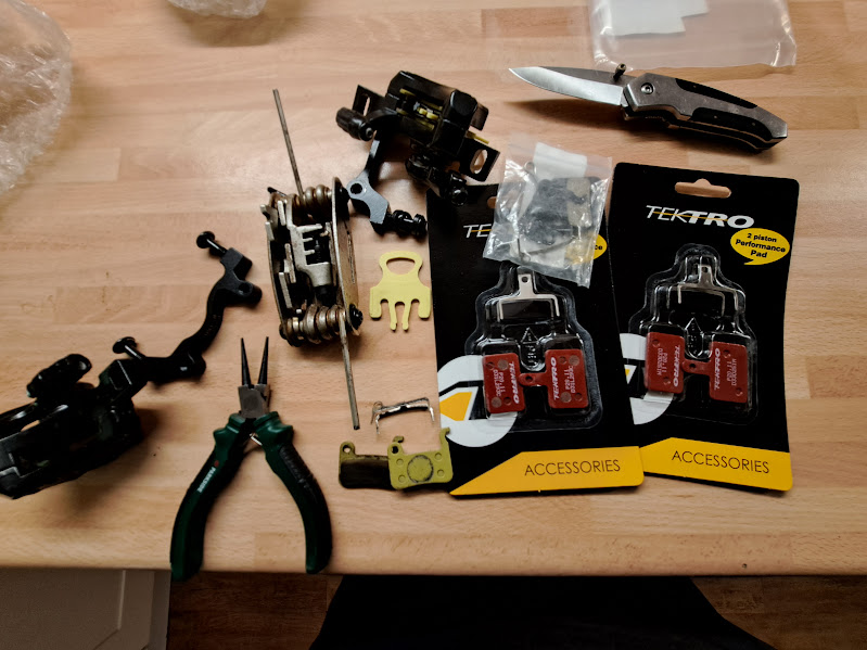

From what I can understand from the specification they are using the term "Open Circuit" to indicate there is a hydraulic oil reservoir and "Closed Circuit" to indicate no reservoir (on cable actuated, hydraulic brake pistons).Screenshot_20250921-091758.thumb.png.b97d44a0c669a8064cbf453034bc6187.png
From what I can understand from the specification they are using the term "Open Circuit" to indicate there is a hydraulic oil reservoir and "Closed Circuit" to indicate no reservoir (on cable actuated, hydraulic brake pistons).[ATTACH type=full" alt="Screenshot_20250921-091758.png]64429[/ATTACH]
That BH-RS911 picture shows a spring behind the piston. That's how I suspect the middle one to be too, which would cause the issue I had.
In a brake with a separate reservoir, when the spring pushes the piston back, more oil can be sucked in from the reservoir, but when the brake is closed and doesn't have a reservoir, the oil gets sucked back from the pistons behind the pads (slaves), opening up the gap between them. That's the problem I was describing above. The only way to adjust the gap is either by adding more oil or adjusting the start point of the master piston.
I don't get what you're saying. These brakes are completely closed. Please can you explain?
I guess from the technical spew that has now covered the page you get the gist of the difference between the two.
So it isnt 'closed' as in all brakes are closed, or the fluid would leak out.
But main point is how the pistons work, so I've looked out a diagram where you can see the post inside the caliper body -fig2 and the parts(fig 9,10,11) that sit inside the piston in order to attach it to the caliper body.
On a closed system, there is no diaphragm, and the fluid is a held between the pistons at one end, and what is effectively a piston in the master cylinder receiver(Not the piston that is actuated by the lever)..
The top cap on the master cylinder has a thumb wheel on it, and by turning it one way or the other, you can advance the pistons/pads(as the pad wears) or retract the pistons/pads, if for example the system becomes hot and the fluid expands**pushing the pads into the rotor until it binds.
I found it best to leave a few 'off' turns so you could retract should you need to.
**On the closed system, (and remember this was 1996, and Hope was the only ones doing hydraulic at that time in the UK)
Heat was the big failing on the first brakes. The closed system meant when the fluid heated up and expanded, the only thing in the system that moves is the pistons, and the heat would expand it so much that the pads would lock onto the rotor, and the only way to release it was to open the caliper bleed valve and bleed out fluid till the pads spread apart.
Long downhills that were becoming common meant the closed system could no longer be used.
Enter the open system, that had a rubber diaphragm that allowed for this heat expansion
The actual operation of the pistons in and out is a result of the piston seal, not the movement of the fluid.

I'm not too sure what you're saying is right. All normal hydraulic brakes work the same. There's some sort of valve in the mster piston that lets air or excess oil back into the reservoir. Logically, it's only open when the brake lever is in its resting position, otherwise it wouldn't be able to force oil down the hose to the slave pistons. In that respect, the system is open to the air in the reservoir and oil can move out of the pressurised hoses into the reservoir.
If the reservoir doesn't have a bellows and is full to the brim, the system becomes closed because the expanding oil can't expand into the reservoir, so instead it expands the slave pistons and locks the brakes on. I had that happen once, so I had to take the reservoir cover off and let some oil drain out. There were no bellows in it. This is the reason that you always have bellows in the reservoir on cars and motorbikes. Some of the more expensive bicycle brakes have bellows too.
None of that is really relevant to these closed cable hydraulic brakes because they don't have a reservoir nor any hoses. The oil has nowhere to expand, and there's no way to compensate for pad wear, so the master piston lever keeps moving forward as the pads wear until it bottoms out and the break won't work. That's why you have to either put more oil in or change the pads.. There is a small adjustment on the slave piston pivot point, but it can't be enough to compensate for significant pad wear.
Agreed totally academic just on how brakes work and the different type there was originally.
