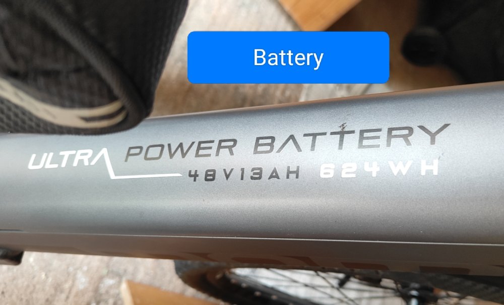

  • Battery: 48V 6.25Ah (6250mAh) – although I’m not fully confident about this, based on this discussion:

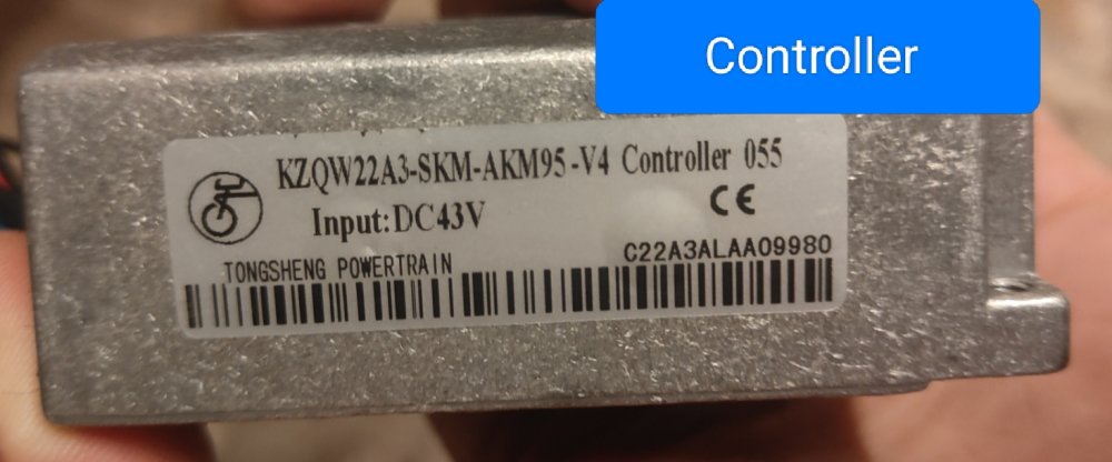

  • Controller: KZQW22A

when he showed me his controller I asked him if he could reduce the amps to around 17amps would this help him if he is able to do it again I am not familiar with his controller.

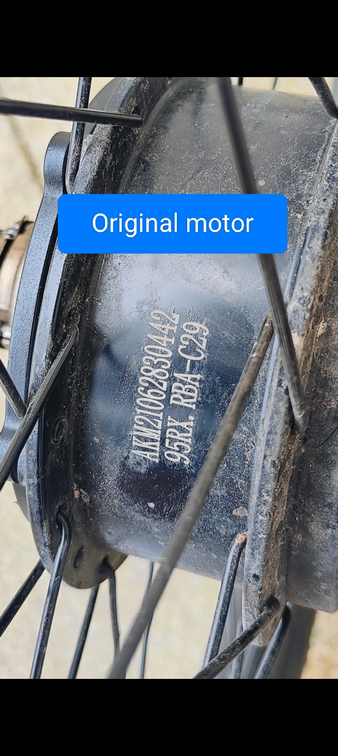

The motor shown in the OP is marked "C29", which I would assume is slow speed for 29" or 27.5" wheel. If he has large wheels, the Yose 350w motor would be the wrong speed.
Just about everything in the Reddit thread is wrong. It's not a fake 48v battery. It's simply a 12S 48v one. The cut-off voltage might be a bit low. If what the guy says is correct (only appears to be hearsay), it looks like Moma used a 36v controller rather than one set specifically for 12S. Run-on is normal for cheap bikes, and they should have break cut-offs to deal with it. It looks like he ran the battery flat and didn’t bother to charge it for some some time, which let it go below the minimal charge voltage. Leaving a bike with an empty battery is very risky, but even worse if his controller was indeed set to 2.91v per cell insread of a safer 3.1v.

T that said can you show a picture of the inside of the controller i.e. where all the wires are going in? Is it full of silicone or can you actually test it in there?
