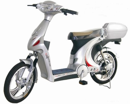

December 23, 201015 yr I'm after a speedometer/computer for my Ninja. Tried a lovely looking wireless one but it wouldn't send the data from the wheel to the computer and had to take it back. I need something that works differently to the usual ones as my wheels don't have spokes, and it is really hard to mount the magnets and the receiver. Wouldn't mind an analogue speedometer which connects directly to the wheel but haven't seen one yet.
December 24, 201015 yr Have you considered a smart phone and app? I hadn't, I am in the same position as you and waiting for my new bike, I sort of stumbled into the idea. I already have an IPhone, so I just need a handlebar mount. Just an idea BlackratI have a smartphone and app and use it to analyse journeys but I haven't found a way I trust to mount it on the handlebars, it would need to be fixed well, waterproof and crash proof. I think if it was all those I wouldn't be able to use the touch screen. I'm after a speedometer/computer for my Ninja. Tried a lovely looking wireless one but it wouldn't send the data from the wheel to the computer and had to take it back. I need something that works differently to the usual ones as my wheels don't have spokes, and it is really hard to mount the magnets and the receiver. Wouldn't mind an analogue speedometer which connects directly to the wheel but haven't seen one yet. http://www.indiaon2wheels.com/wp-content/uploads/2008/10/2009-kawasaki-ninja-zx-10r.jpg

December 24, 201015 yr I have a smartphone and app and use it to analyse journeys but I haven't found a way I trust to mount it on the handlebars, it would need to be fixed well, waterproof and crash proof. I think if it was all those I wouldn't be able to use the touch screen. http://www.indiaon2wheels.com/wp-content/uploads/2008/10/2009-kawasaki-ninja-zx-10r.jpg Wish I could say mine looked like that!
