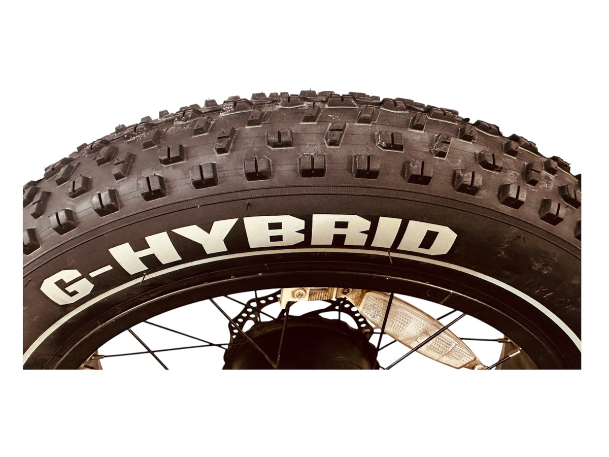

I am using an off-the-shelf Chinese 500 watt 36 volt hub fitted to a 20x4.0 inch rim. This will both fit one of my space constraints and also allow lower ground pressure and shear force when applying power on lose ground. It also works with my two 36v batteries (one 7.5 |AH, the other 20 AH)
So the first problem; I live in England and I am finding it the devil of a job to get hold of any 20"x4.0" inner tubes or tyres in this country, does anyone know of anywhere that I should try? Supply times from Hong Kong and China are grim right now.

Amazon and eBay might be a good source.
eBay for example:
[/URL]
This company stocks inner tubes and tyres (,I have never used them)
