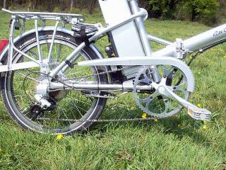

My way of dealing with this loading and stability problem on a 20" wheel rear hub motor bike:
The original stand was a twin leg one, this being needed to hold the chainwheel off the ground when the bike is folded in half, but that stand fouled the derailleur chainline. Also, with the handbrake necessary for heavy trailer use on hills, a propstand has to be used to keep the rear wheel in firm ground contact. Therefore two stands have been fitted. One is a frame tube mounted propstand with pushbutton instant length adjustment for uneven surfaces. The other is the esge folding twin leg design from Pletscher. This is fitted to the usual stand platform using a thick spacer to clear the underslung rear V brake, and has some of it's top mount cut away to give clearance for the brake arm cable bolt. Below you see three photos, first showing both stands folded up showing how the twin legs fold neatly into the same side, then centre with the prop stand down, and finally, the twin leg stand down and clearing the chain as it would be when the bike is folded.
The Pletscher isn't as stable as some wide leg stands but necessary to avoid fouling the chain on my bike. An ordinary twin leg stand may be ok on a full size bike.

It was a conversion from single speed to derailleur gears and with a huge 60 tooth chain ring. Those with the 20" wheels meaning a low bottom chainline, hence a fixed two leg stand fouling the chain whether stand up or down.
Here's a side on photo taken during the conversion amd before the stands were fitted, showing the low chainline etc:
