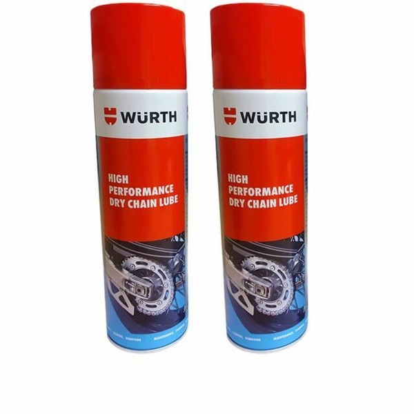

What do people use as a lube on their chain, and drawbacks and pluses of their lube?
Same as on my motorbikes
Easy to apply and not messy..... Makes for a near silent drivetrain

Thats an interesting option, I've got a full can of Yamalube fully synthetic motorcycle oil, no longer using as I currently ride KTM.
How do you apply? Brush and wipe off excess.
The Wurth dry lube I currently use is spray and dries on with no fling off

GT85, primarily because with a full chaincase it's easy to apply without any dismantling. I do like the look of that Wurth stuff though. Is there anything else like it in an aerosol?

I wouldnt say that motorcycle dry lube is a "snake oil product"?
I have used the product consistently on various motorcycles whose power ranges from 70-120 BHP, and the product copes admirably with the 1hp (?) delivered by most of my Pedelecs. TBH I've never had an issue with the derailleur gumming up, but then again I maintain the drive-train components regularly.
Everyone has got their own preference for lube, mine is Wurth dry lube. ;)

Agree the chains are different, disagree on the gumming up of derailleur;)
Wurth dry lube works fine for me, easy to apply, smooth running chain, no dirt pickup and no gumming!
The foul sulfurous smelling gearbox Hypoid oil works for you!
Horses for courses as they say
