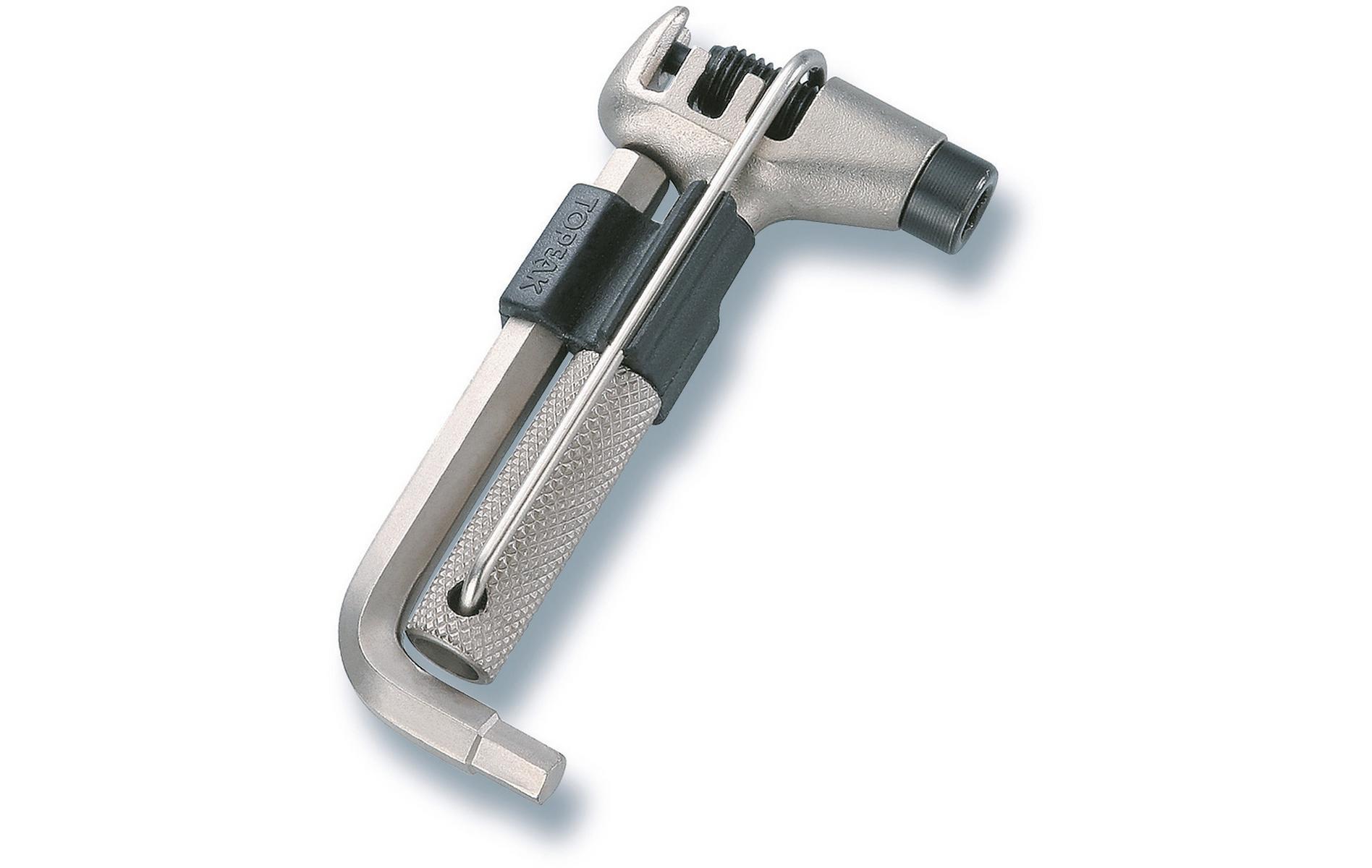

Thanks, obviously the 120 link chain had some links removed . I'll get myself a chain link tool. Any suggestions for a good one?

Just taken my new chain off and hung it from a nail on a length of timber, and SW is correct, it's two links longer than the one its replaced. I had previously measured it top of a flat bench and they both looked the same length, but obviously not.
Got a chain link tool arriving today so I'll remove two links and refit it.
