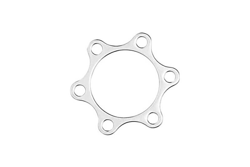

No, the (140mm) disc fits OK, however I tried a larger disc and that did rub against the forks. I could try the extra washers solution but I'd have to move the disc out somehow as well??
16,205
6,319
you can get disc rotor spacers.
