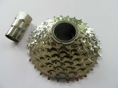

If you can't get at the screws, you have no choice but to remove the freewheel (gears) for which you need a freewheel removal tool with a big hole in it to clear the axle. Note that most don't have a big enough hole. The DNP one does and so does one of the Park tools, but I don't know the number. Maybe someone will tell us.
While you have it off, it might be an idea to change it for an 11/34 DNP freewheel, which will give much more comfortable pedalling in top gear if you find your top gear to low at the moment.
