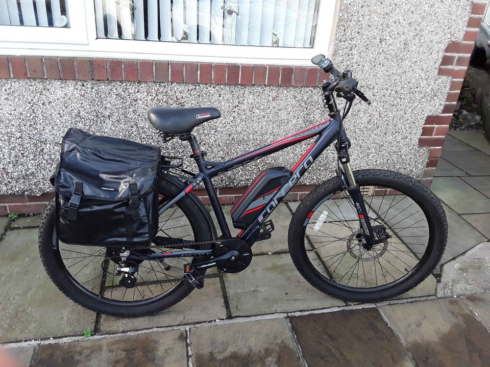

Can we see a pic of the bike.

The wire was cut by a misguided husband trying to help after looking at advice on the internet
20,138
8,231
60
That isn't good, if hubby simply cut the wires he may have caused issue with the controller or shorted the display.
Looks like he has cut the wires to the button pad for whatever misguided reason.

Hi it’s Airmyn in East Riding of Yorkshire about half hour from Hull, York, Leeds. Can’t see any markings whatsoever on the casing for the battery but there’s a sticker on the battery. The wire is a Julet and hubby cut the wire in an effort to ‘diagnose’ after we saw some advice on the internet. Thanks again
