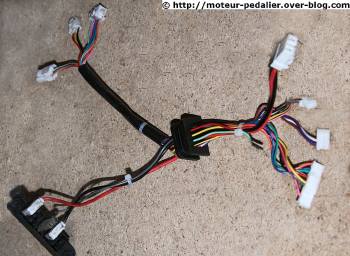

Thanks for comments folks but I took the advice but no place to plug anything in the Motor is 26v Panasonic ref NUA02 BRA could it be prior to socket 2011?
53,478
30,790
With the old type Panasonic crank motor the connectors are underneath the cowlings. Here's a photo showing what comes out of the motor there, the battery platform and the three connectors, one of which should accept the throttle:
With the new type motor it's similar except all three of those connectors are white, seen on this photo at top left:

The connectors are under the cowling, left hand side if I remembercorrectly. They are usually inside a tough plastic bag which has then been pushed inside the frame.

Great many thanks folks, I love pics , now I will try to get one below 82euros.
