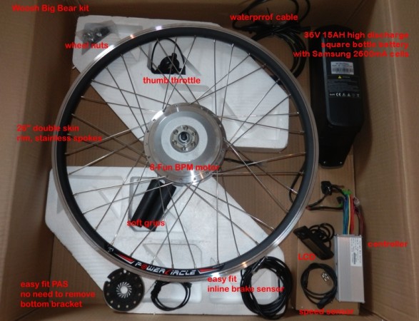

You need a very robust high-torque low-speed motor. I'd recommend a kit with the 201 RPM 500w rear Bafang BPM motor, 25 to 30 amp controller and a 20 aH 36v battery. The motor is not too heavy and has an internal free-wheel so that you only turn the wheel without power, not the motor. You can get them from a number of sources, but BMSBattery.com is the best one-stop shop.
The nearest equivalent in a ready-made UK kit is the Ezee kit, which is about the same size and weight, but a bit less torque due to the controller being only 20 amps.
There's som nice crank-drive kits from Bafang too. I think that their 500W BBS02 might be an option, but there will be a tremendous strain on the drive train when towing, which will make gear-changing difficult, and probably lead to early demise of your rear derailleur, chain and cassette.
You can also get a plug-and-play MAC kit from Em3ev.com, who have some nice frame batteries, but the pedal assistance control is not as good as the BMSBattery controllers like the S12S.

I agree with others who have said BPM. I think you need to go 500w, and I suggest putting it in the rear. If your donor bike is more than 7 speed, then go with the Bafang CST instead (Cassette version of the BPM).
I often tow my lad on his bike behind my CST motored bike.
As far as £3000 budget goes, well that's easy. Build 3 of them!!
You should be able to get the kit from BMS for around £500-£650 (including delivery and import duty), and a half decent MTB for £200-£300.
