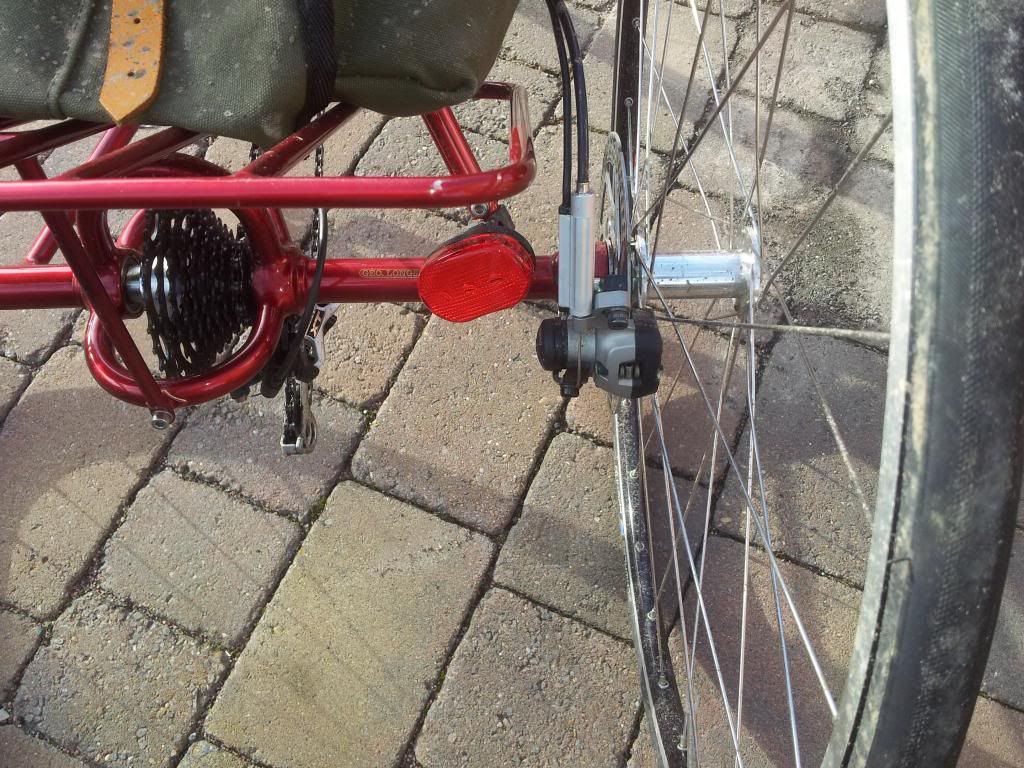

I went to see Geoff today now that he's finished his trike. He has the new Oxydrive kitthat now comes with the Japanese Dapush motor, Dapush LCD display, hidden wire brake sensors and Oxydrive 8.8aH bottle battery with Samsung cells. Geoff's workmanship is superb and has resulted in a very neat installation. Hopefully, we'll get a report on how it performs in the near future. Here's some photos:
Deleted member 4366
Geoff has a hollowtech crank, which means a bit of jiggery pokery to install the pedal sensor. Here's the solution that works with most pedal sensors. The centre of the magnet ring was drilled/turned out to 25mm to go over the shaft; remove the spacers from behind the bearing holders to make the space for the magnet disc; remove the sensor from its metal bracket and fix it from the other side. This gives the right spacing and clearance as you can see from the photo:
Installation of brake sensors is very straight forward with the hidden wire type if you have cable brakes.

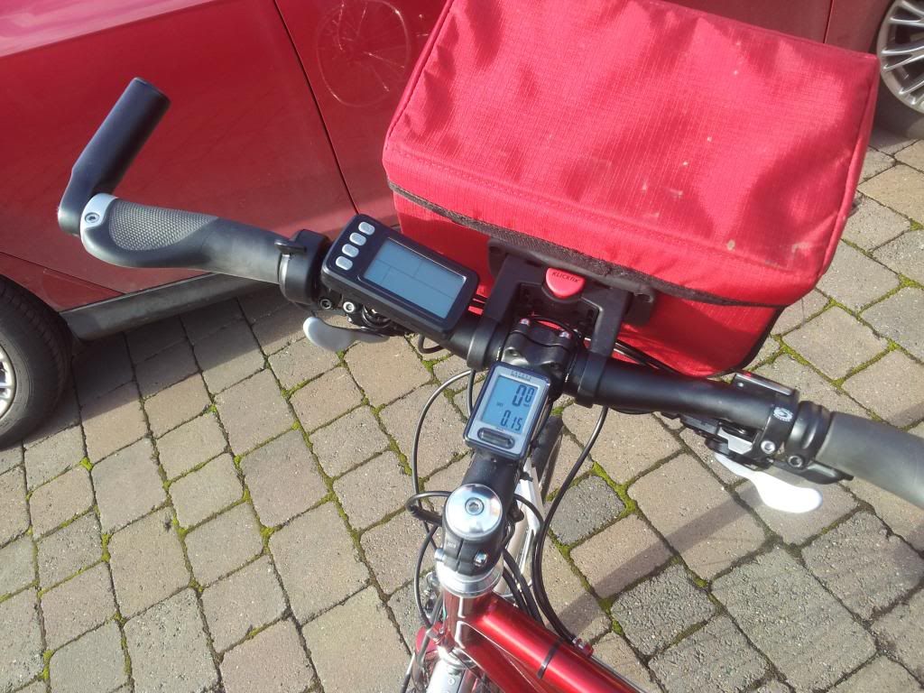

This is the FIRST entry and obviously had a few minor issues....loose coonections/1 loose spoke. under the circumstances and it being the initial running in period i would consider these all very minor issues.
Until i have ascertained the total mileage available for a battery it is my intention to keep cycling at this level of PAS 1 [a range of 5 is available, [making the assumption that each PAS level is 20% of total i.e. 250 W - so PAS 1 would be 50W from 0mph up to max speed setting?]]. Since I have gone the way of a Trike then e-trike my targets now are much less....i.e. 12.5mph for a maximum of 50 miles.[MS makes you appreciate the limits of your capability.]
I would appreciate any comment regarding the spoke size , including the key size. As i have a lot of cycling tools i have not come across this key size in quite a while and do not have one. Also has anyone built their own wheels utilising smaller gauge spokes and high grade rims?.
I do know that in major races [Tour de France] a maximum level of 500 watts is used for training when racing up major hills, so would assume that if that power is used for standard racing gear systems on very light wheels, then I can see no reason why motored wheels up to 500 Watts [my Oxydrive is 250W] cannot be built with light rims and light spokes [spoke length excepted].
Regarding the display supplied by Oxydrive [it is now different and for me a better arrangment] you can change the readout from Km/hr [default] to mph. I am not sure whether that changes all readings [question has been asked]. I have set the maximum speed to 16 [mph/Kmph ?].
by leaving my original Casio display on as well i have an accurate readout which I can use as my default. this is showing that the controller to the motor is shutting down at approx. 13.5 mph....difficult to be exact as the motor is very smooth and quiet too.
D8veh did explain that it would be best to set the maximum speed setting because of non-smooth shut off/start up of the motor becoming awkward to deal with whilst riding.As yet I have not noticed any awkward surges when the motor comes back in so will keep as it is.
Obviously by keeping to PAS 1 and not having my maximum speed any higher than necessary, this will save excessive use of the battery and extend the cycling distance...remember 12.5mph & 50 miles is the target.
