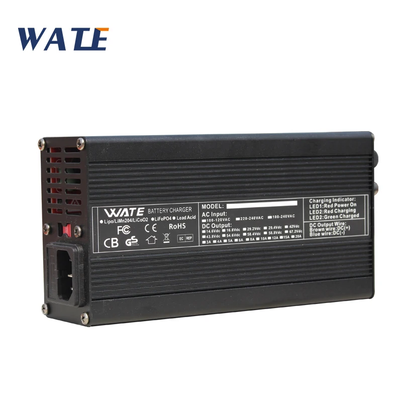

Anyone got any recommendations for a sensibly priced 52V 4-5A charger that can be set to 90%?

It's not a charger you really need for 90%, ideally you need a BT or Uart BMS which then can have the balance correctly set to 90%. Then you know for sure the cells will be looked after correctly and can check cell balance when ever you like.
The pack has a bluetooth BMS and will balance at >50% charge. Was thinking more about longer term cell health and not having to check the BMS to see when it hits 90%.
20,131
8,230
60
Use a standard voltage charger then, set the BT BMS to 90%/ 4.1v per cell balance. Once the 90% balance charge is reached the BMS will switch off the current and the chargers light will go from Red to Green as normal.

I have played around with both adjustable chargers and bluetooth bms. The basic (bigger than 2A) china charger with the aluminium housing and fan is easy to open up and turn down the voltage, works well with a non BT BMS. The BT bms is a bit fiddly to regulate the final charge voltage, I found it easier to tune the charger. Finally, the Meanwell chargers are a step up from the the usual ebike charger, with externally adjustable current and voltage, long warranty and excellent build quality. They are much more solidly built and the fan only runs when needed.. Imagine the efficiency is higher also. NPB360 is the one I have.
