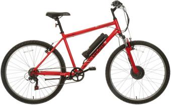

Reading through your requirements, I can't help thinking that you would be well served by the same bike as I have:
I've had mine several months now, and it's pretty much become my go-to bicycle, especialy when I'm feeling a bit lazy but know that I should cycle.
I really must do a proper review on here of mine. It's not the most fashionable, but it would meet your needs, all while providing a whole lot of fun on a budget.
All the best in your search.
Reactions: Muddyfox

It would fall under most folks' radar as they start to educate themselves about e-bikes, simply because on paper it's kind of ... well ... rubbish!
In reality though, it's great. 35Nm trque from the front wheel motor, simple, basic cycle parts that work, and a frame/fork combination that is specifically designed as an e-bike.
The wheels are superbly built, and it's not too heavy either.
There are various ways to ge a 10% discount from Halfords that brings it down to below £500.
Reactions: Muddyfox
