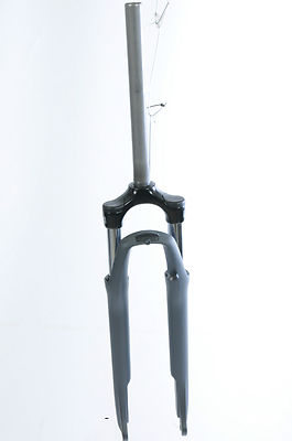

so I have my bike back and I think the new aluminium fork provides from the LBS looks better, I am waiting for the torque arms to arrive
what do tou think guys? is a thicker aluminiun (still aluminium of course) but I think with the torque arm it will be safe

I know he put the wheel wrong, can get water to the motor in that way, I will change it when I install the torque, he put a the washers in wrong position as well, and also a weird like "plastic washer" to fill the gap
Hope to finish the proper installation of the wheel when the torque arrive but so far to me this fork have a chance

Plastic washers have no place in the motor wheel instillation, replace it with a12mm one.

They look like steel forks to me, not aluminium. Test them with a magnet.
He's added the spacer to keep the motor off the fork because the drop-outs are on the centre-line, not inboard. You must replace the spacer with proper metal ones and hope that the forks aren't too splayed to lock their movement.

i just tried the magnets of my PAS disc near the fork and zzzzzttt! attraction! and in the same way I tried on the frame and same,
But yeah, the fork have more attraction force than the frame so maybe thats a clue this new fork is steel
I will install my torque arms soon and hopefully all will be good

The easy fixing point to anchor a T/A would be to drill a hole in it to line up with M/G stay anchor point with the M5 Allen bolt above in the pic.
