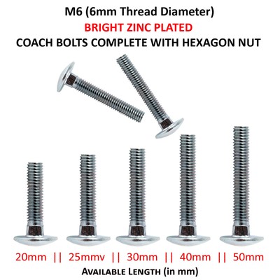

Is it high tensile bolt like this one?
I'm not sure what the grade mean? there are also these much more expensive but higher grade? Not sure it makes a difference:

Mild steel is best because it's more resistant to metal fatigue. I wouldn't weld anything because you're much more likely to get metal fatigue in the welds.
High tensile can be worse because it suffers from fatigue more than MS. What he needs is a bolt with the correct length shoulder that runs nearly all the way to the nut. I would use mild steel bolts.

Thanks. I was thinking to buy these parts:
This 25x25x5mm:
Clamped with this high tensile bolt 12.9:
The only mild steel bolt I can find on ebay are these
And they don't give me much confidence they'll last
