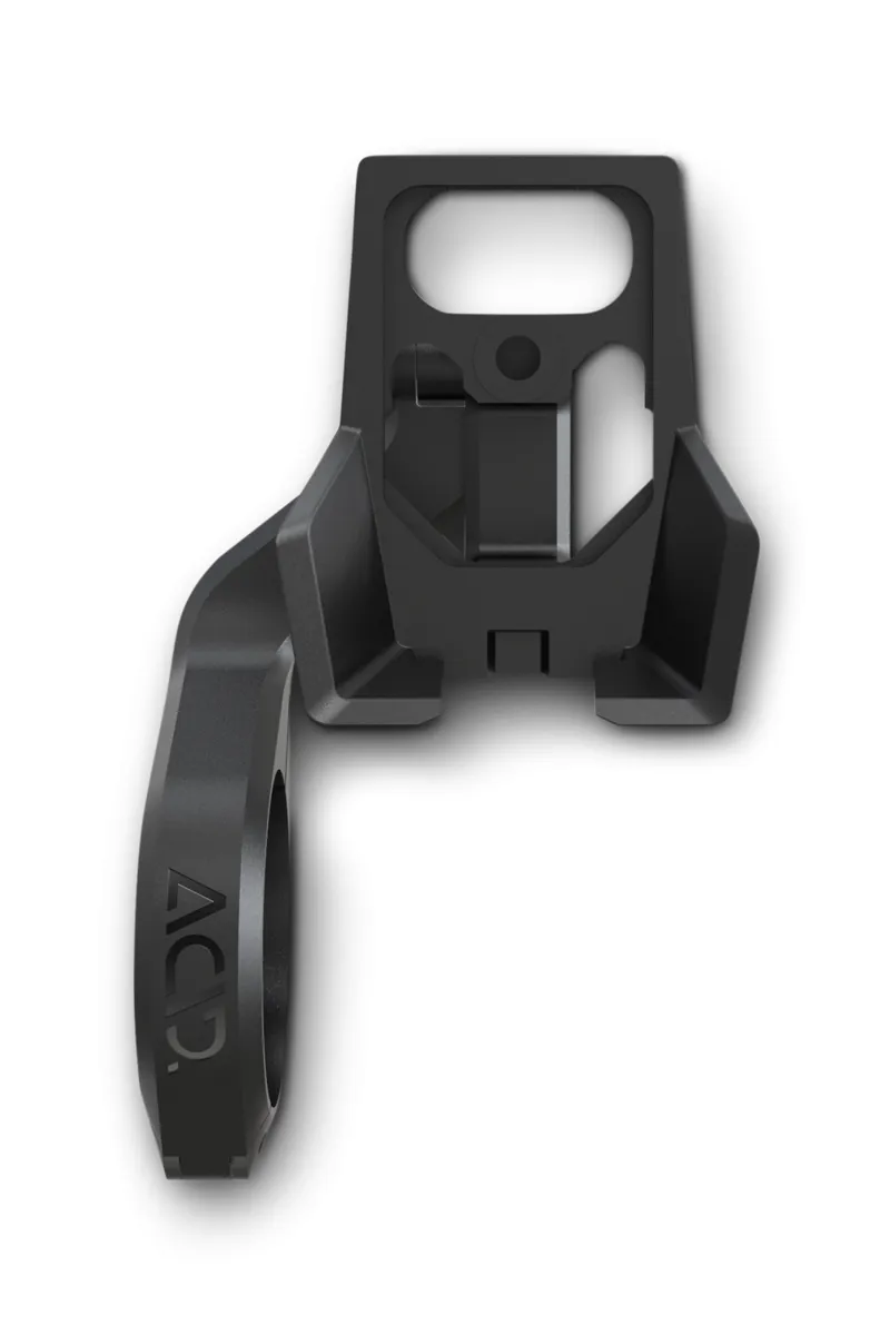

well that just looks shite so the stem mount is going to be replaced with one of these to get it out of the way.
45324
