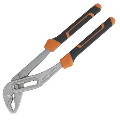

There's an expanding wedge-bolt arrangement on the inside, which grips the handlebar on the inside when you tighten the screw. If it's not too tight, you should be able to grip the red part with pipe-grips or mole-grips, you can probably wiggle the whole lot out.
