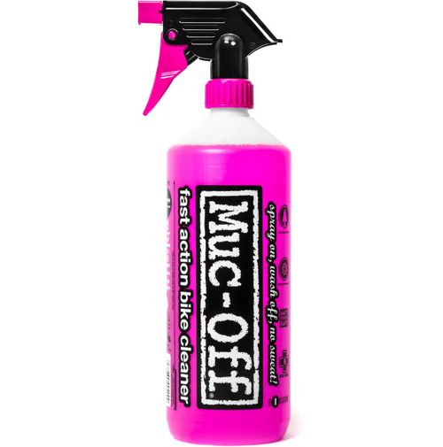

Try to keep degreasers away from chainring and bearing. Clean chainring with brush, cloth and maybe plastic pick, shouldn't need degreaser.

I’m just a little cautious about spraying lube and de-greaser around the motor sprocket, I take mine off every time to clean it so I don’t inadvertently spray de-greaser etc. into the motor bearings, OCD I know but the more time I take to look after the motor… hopefully the longer it will last. That said I have no problem taking it apart and replacing the bearings myself, but who want to do that.

I have been using Muck off dry lube spray, but it looks like the version for damp rather than wet conditions.
