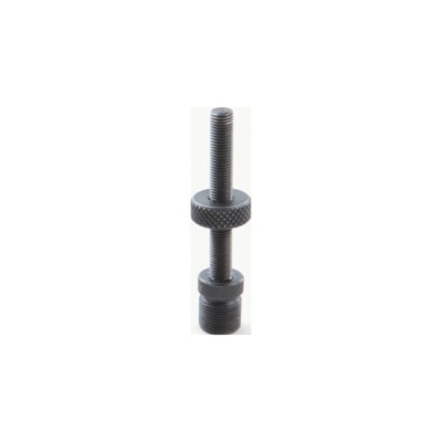

You may need this tool to hold the removal tool securely to the bottom bracket's axle.
You can use a long M8 bolt or a crank bolt to do the same.
I have a 2ft long tube to extend the spanner and sometimes have to push the tube down with my foot.
