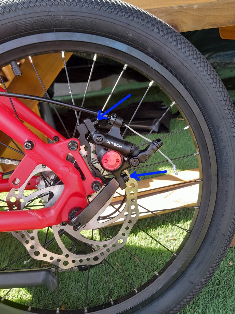

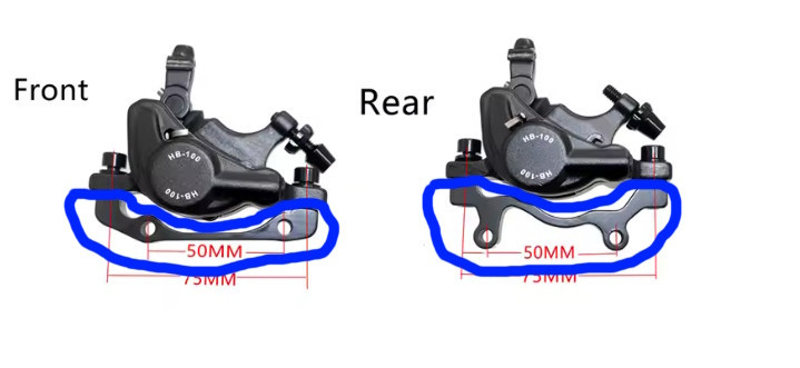

Keep this image with you when you fit the calipers, so as not to get in a muddle about what way the adaptors fit:
This picture shows where I added two 2mm washers to each bolt which attaches the rear adaptor to the frame. I later corrected this to one 2mm washer on each bolt.
It looks a bit complicated but it's really not, and every bike will be different.

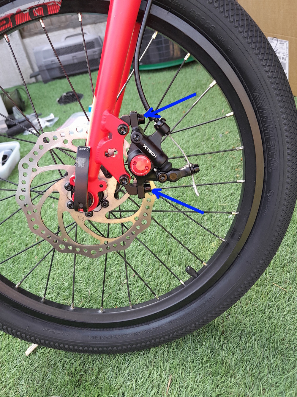

These are the bolts you need to loosen, they bolt the caliper to the adaptor.
Thanks Wasby will check that when new calipers arrive, I've never done that before with my brakes no wonder they not good.
