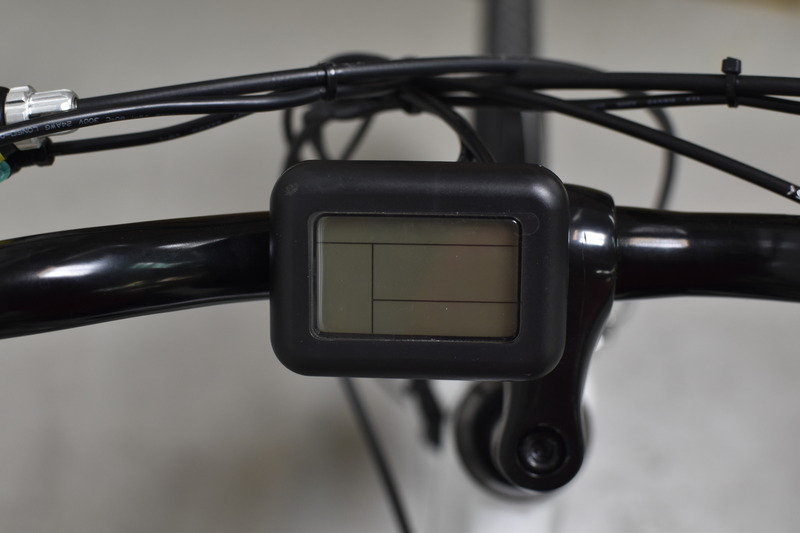

KKM100SX motor will be the desirable Aikema or clone (Q100). LCD looks like a KT LCD1, so it has the desirable KT controller too. As ong as you're not too heavy, that's the one I'd go for.

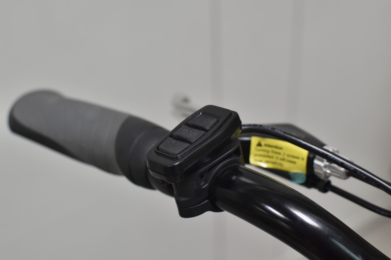

I had a look in person at the white e-bike OP was referring to, I found out the following, sorry about all but 3 of these being off topic:
  • It has been branded Neuzer Palermo, Kellys SLF001, and StoneFly E-Bike in the past, with various prices ranging from 555 EUR to 699 EUR
  • minimum seat height is ~53 centimetres on the women's version, that means a teenager could use it as well as an average adult (I'm 173 cm tall, I need 73 cm from centre of bottom bracket to top of the saddle) I didn't check the max, but assume 80cm-ish since it's a 19 inch sized frame on the women's version
  • the thing on the handlebar is indeed a Suzhou Kunteng KT-LCD1
  • walking assist works
  • the battery pack is about 38 cm long, therefore it might be the Portapower YL-TFH1, 313 Wh mentioned above
  • the hub motor has this written on it: akm160600691 bbe3628a
  • i've attached a picture of the battery connector I've taken
  • light is "Kendo by Spanninga" whatever that might be
