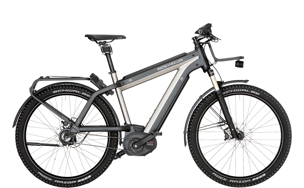

The R-M Delite uses a cageless water bottle and it only costs £9000! (The bike, not the bottle)
it was looking at the RM supercharger with its itegral bottle mount that gave me the idea of a cageless bottle f Not sure where you have seen the £9000 tho.. thought it was about £4500. I thought the supercharger with 2 batteries and Rholof was their top bike at aroung 6K

My points of interest are..
1000w integrated battery.
No fs bearings to service.
Factory fitted lights, rack and mudguard.
Rholof gears.
Carbon belt option.
And I think it probably the best looking bike I have seen.

the two batteries on the Supercharger look like Dorado batteries.
If you need 1000WH battery, you could have one on the downtube and one on the rear rack with off the shelf components.
