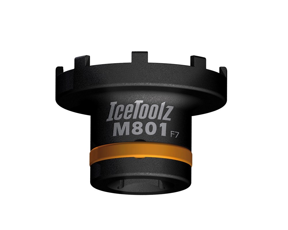

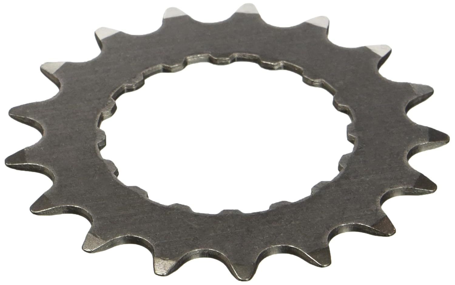

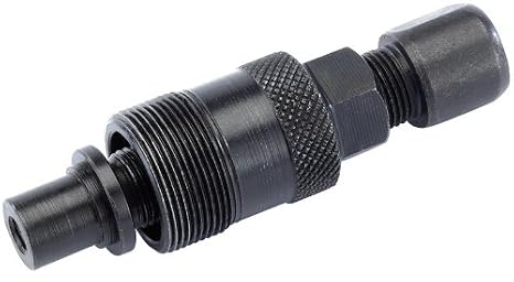

Decided buy a bigger front sprocket and so purchased the necessary tools to change it - crank puller and Chainring lock tool. Took the crank arm and sprocket off my bike, unwrapped the new sprocket, and dropped it. Its a strange feeling watching a brand new front sprocket bounce on the floor and fall down the drain. Got the wife to put her arm don to try and retrieve it, put she couldn't get it.:mad: :D
Another new sprocket ordered!
Bought the tools from Amazon..
Draper crank puller £7.96
IceToolz lockring tool £16.23
Connex 17T sprocket
