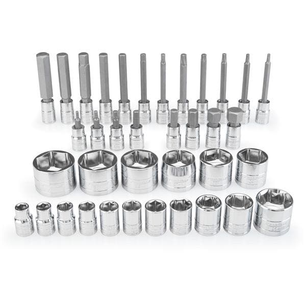

The Park Tool is the front runner at the mo, can't beat that torque range:
...and this Makita set:

the kit comes with a adaptor for the torque wrench and has all the torx and hex bits you need had mine for years now.

I don't do small torque ;) Good point. Let's face it, any measuring device relying predominantly on a big spring, is highly likely to be affected by the weather a little, and by moon phases much less. But it is a Park Tool... tool... therefore has to be better than most other similar tools relying on big ol' springs, else the furore on Youtube and the interwebs in general would be bitter and tumultuous indeed. I need accuracy most around 10 to 50nm (to tighten the torqueier bits on the bbs01b), so am now veering once again towards the Sealey 7Nm-112Nm "Calibration tolerance in accordance with BS EN ISO 6789-1:2017" , at 38.89 squids. The Makita set is for the sockets.

this is 10 to 80 cheaper and comes with socket adaptors.
tho out of all my tools i mostly use that kit and small ratchet
I'll try tightening various bolts to remove that slight creaking noise by hand first, but I think I may have let it go on too long... I've applied threadlocker to all threads, but some thread(s) or other might be on it's/their way to knackerland... and I'll order that Draper torque wrench and the Makita socket set, unless someone suggests better product(s) at a reasonable price. Cheers!
