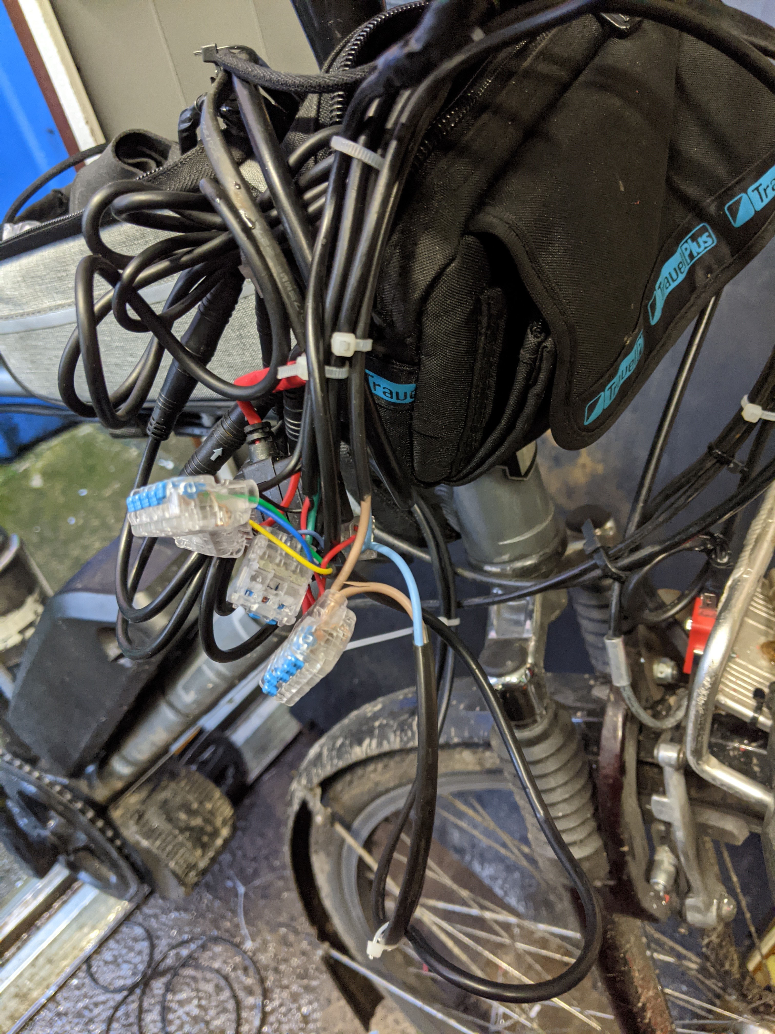

Hi
Think hubby has finally got everything working as it should now - told him it helps if you read instructions properly - still trying to work out though what PAS sensitivity range means - hopefully see attached picture - thanks to everyone for your help with my useless hubby 20200823_135121.jpg

Hi
Think hubby has finally got everything working as it should now - told him it helps if you read instructions properly - still trying to work out though what PAS sensitivity range means - hopefully see attached picture - thanks to everyone for your help with my useless hubby View attachment 37964
