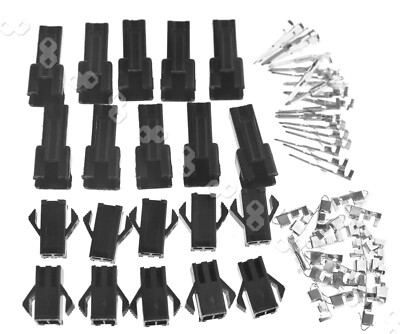

Hi I got to the controller to take the pedal assist off can anyone tell me where i can get an identical replacement as I’m no good at soldering wires I know the red wire is the voltage wire 40648
vfr400
Jun 12, 2011
9,822
3,994
Basildon
The sensor is very common, but the connector arrangement isn't. You'll be very lucky to fond one like that.
If you're very dextrous and have two pairs of small pliers, you can crimp on new connector pins and clip the pins into the connector blocks you have.
To get the pins out of your present connectors, or the connector from your new sensor, you push the wire into the block, then push down the barb with a jewellers screwdriver or a darning needle, then pull the wire and it should slide out. if you're lucky and are careful, the pins will remain on the wires so you can just slot them into the new connector body. Make sure that you get them in the right sequence to match the colours of the wires in the connector on the controller side.
The colours are the same on the controller side will the blue on the link to the new pedal assist you have sent be the neutral and the yellow be the the same as the white one as don’t want to blow the controller lol
That's an excellent question. Our Chinese friends are not very consistent when they use these colours. Red goes to red. That's easy. According to other listings of similar sensors, blue is ground, so it goes to black, and yellow is signal and goes to whatever third wire you have. If it doesn't work like that, swap the blue and yellow wires. no harm will come if you get those two wrong. For testing, you can leave the pins out of the block. just carefully slide them onto the pins. Once you've confirmed the sequence, you can put them in the block.
Some useful advice to save you a lot of work, confusion and frustration: Install the new sensor behind the BB, then put the magnet disc on the shaft and test it before putting the pedal or crank back on. Try turning it in both directions. If it works backwards, flip the magnet disc. Once it's working, you can assemble the crank with confidence.
