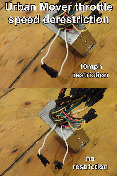

I got a throttle today for my 2nd hand UM36X, in the process of installing it I took a couple of snaps of the 10mph restriction wire for future reference to anyone wishing to derestrict their Urban Mover:
After derestriction you may get up to 20mph on the flat with a good, fully charged battery just from the throttle, pedal at the same time and you can break 20mph.
My UM36 is over 4.5 years old and my UM36X is over 2 years old, both have identical controllers, but it appears the controller design has changed since then, removing the white restriction wire, certainly with the 36v UM36SX not having a throttle option.
Personally I find the throttle invaluable with the steep hills round here, without the throttle I have to push a heavy bike up certain long steep hills, but with the throttle the bike carries itself up and I just have to walk it.
