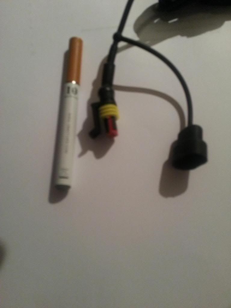

Here's an example of the sort of thing, which is part of a hardwire Samsung phone charger assembly for motorbike :

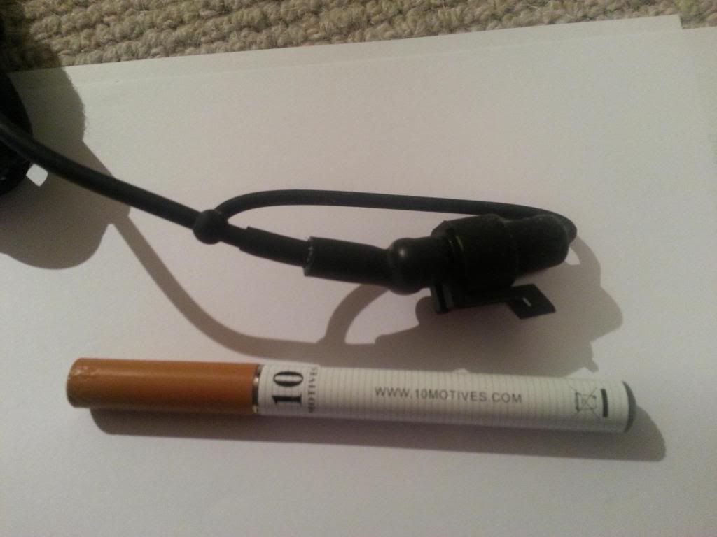

In the photo above, the female socket into which the charger lead plugs is open ready for coupling. When not in use the charger lead is disconnected and the socket capped off. Like so :
I'd like something similar which I can fit to the power supply cable for my largest front light, as this will only actually be fitted on to the bike mount when I'm going to be out using it in harsh conditions. Rest of the time it'll be off the bike. So it needs to be able to be unplugged and the socket capped off like the system above (it's to be hardwired off main battery).
