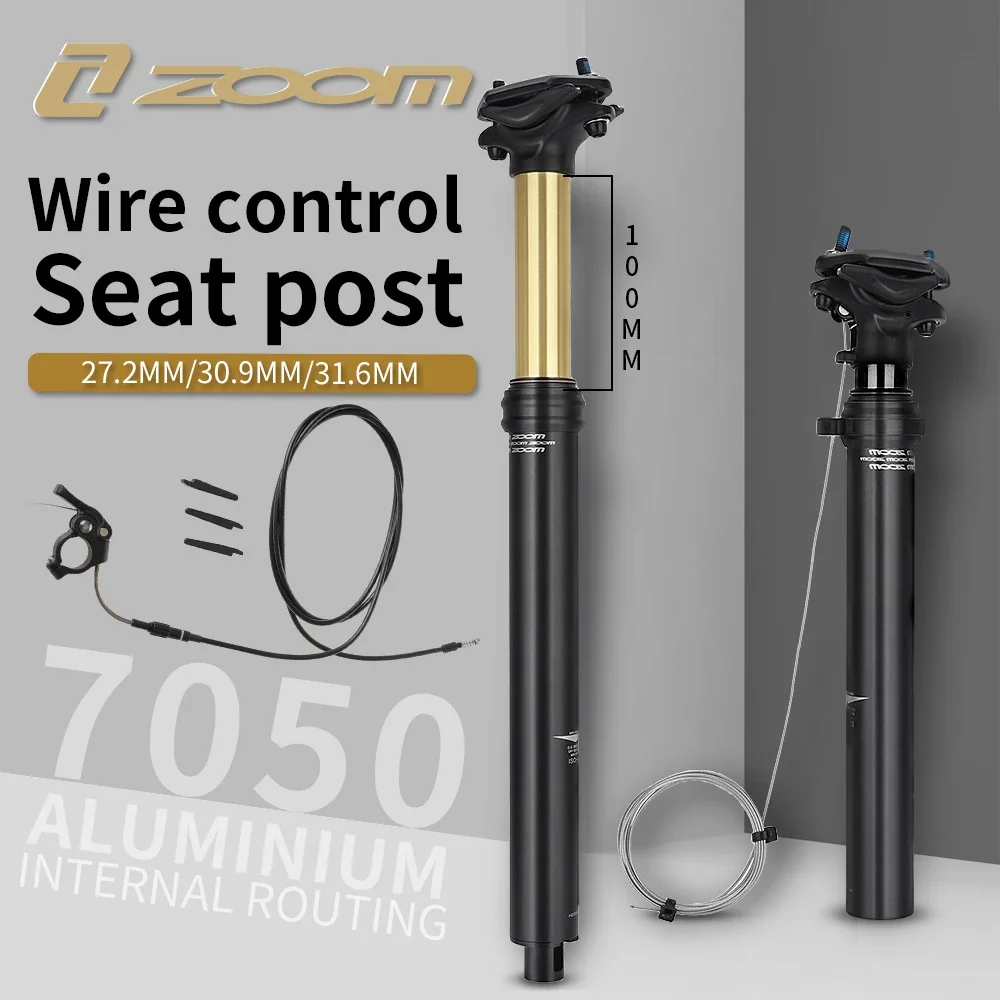

She wanted a dropper post fitted , so it's an extra small frame, so I was thinking of a 100mm dropper post , that seems the smallest. Also there's no hole in the frame for the cable to come out, can I just drill a hole? any tips on placement ?
Are the ones for £50 on Ali a express OK ?

oh this one does a 100m external routed one which looks like would fit a small seat post tube
70mm here
Trans x, comes with a dropper lever, so at least you don't have to buy one of those too.
Only down sides are you're stuck for post diameters at only 31.8 and its internal.
Just remember to go easy on the seat clamp, too tight and the post gubbins might be damaged, or at best not function smoothly
