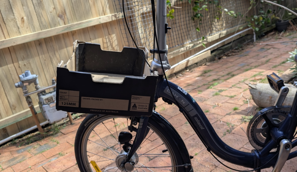

@Woosh is the in frame battery in the Faro easily removable ? Can it only be charged on the bike ?
it is possible to remove the battery but can only realistically be charged on the bike.
Behind the aluminium badge at the front of the bike is a large cutout where you can pull the in-frame battery out. To do that, you have to remove the steerer tube first.
Messy.
