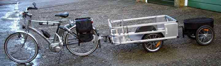

The Giant-Panasonic bike, the standard Quando and the modified Quando are shown in that order in the first three photos on my Trailers webpage.

I love the trailer towing a trailer and you made me giggle! :D
53,509
30,817
You should have seem that pair after one Xmas when I rode it to the local tip piled high on both trailers with packaging and topped with two Christmas trees.
That raised quite a few smiles on the way!
