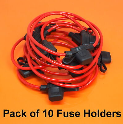

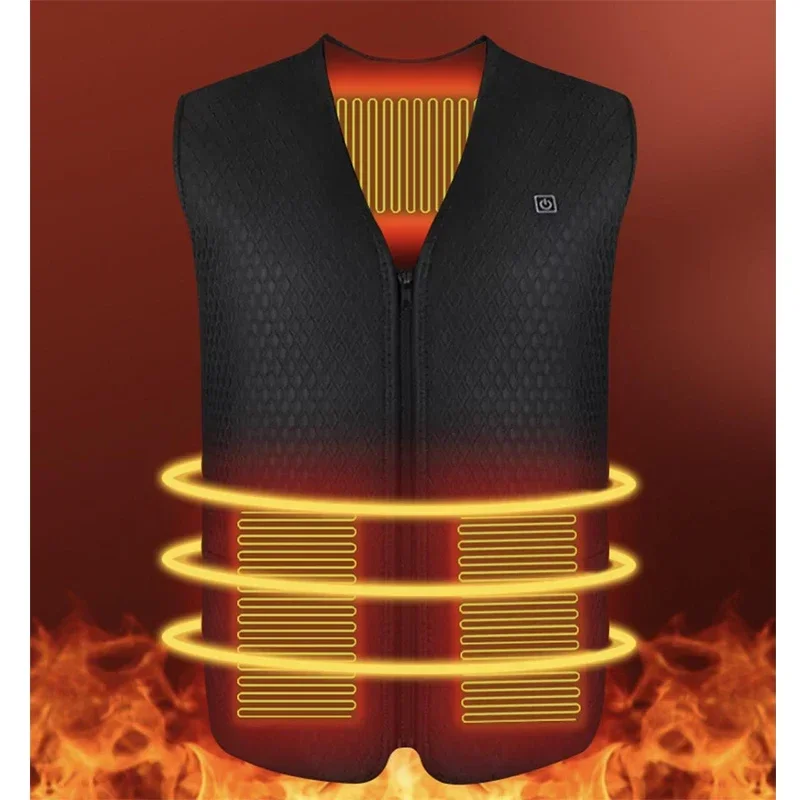

Everything else has arrived for my winter heated cycling suit project. I'm one step closer to happy heated cycling feet. I'll attach the car chair heating elements (white with yellow edges) to two inner sides of a sleeping bag, get myself really toasty in cold weather for the ride home.
The heated waistcoat isn't bad - at least in this instance from this seller, turns out the size stated in cm, is the exact size of the garment, so if you're buying one, account for an extra inch or more for a comfortable fit. Clearly not using much power because my cheapo Amazon "Teknet" power bank lasts 5 hours. Power bank and wires remain cool. Keeping the power bank inside the pocket next to a heating element, doesn't seem a wise idea, and there are no upper pockets away from heating elements on the waistcoat, so I'll connect an USB extension lead and situate the power bank somewhere else.
I can secure the heating pad set (pictured below) to the same or some other garment, it might even be safe to do so - I'll measure how much current each set of heating elements draws. I might be in the market for another power bank. They never say what cells any given powerbank contains.
I could line two sides and the back of the winter cycling boiler suit upper section with the heated car seat elements, to be powered by my ebike battery. The heating pad set could be used for heated trousers, powered via a DC converter by the ebike battery, plugged into the handlebars, along with the heated insoles.

I bought a jacket with heat elements built in for £20. Not been cold enough for it the last course of years. I'm thinking this could be the year though
There's always a situation when wearable heating could be useful. The heated waistcoat I bought can be worn under a light fleece and/or jacket, making for lower volume and weight. Of course there is the weight of the power bank, but I often carry one of those anyway.
This PWM controller arrived the other day. I've also bought a cheapo 5A 12V power supply to test current drawn by the various heating elements I intend to combine for my heated cycling suit. I may buy more heating elements and power supplys, plus other stuff for other clothes. Could make a heated hoody, with heated hood. Unsure I'd want a headed hood. People could accuse me of being a hothead and be right.
